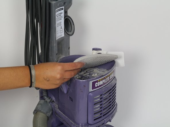

      • Ensure that you are removing the filters from the vacuum in an area that you don't mind getting dirty because the filters will be very dusty.
      • Lift the latches on both sides of the vacuum to release the dust canister.
    2. Shark NV352 Filter Replacement: crwdns2935265:02crwdnd2935265:01crwdnd2935265:02crwdne2935265:0 Shark NV352 Filter Replacement: crwdns2935265:02crwdnd2935265:02crwdnd2935265:02crwdne2935265:0
      • Tilt the dust canister forward to release it from its position.
      • Carefully lift away the dust canister and set it aside.
    3. Shark NV352 Filter Replacement: crwdns2935265:03crwdnd2935265:01crwdnd2935265:03crwdne2935265:0 Shark NV352 Filter Replacement: crwdns2935265:03crwdnd2935265:02crwdnd2935265:03crwdne2935265:0 Shark NV352 Filter Replacement: crwdns2935265:03crwdnd2935265:03crwdnd2935265:03crwdne2935265:0
      • Remove the upper filter by lifting upwards on it.
      • Now that the lower filter is exposed, remove it by pulling it upwards.
