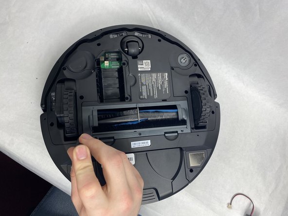

    • Remove the two 11 mm Phillips screws holding the battery plate in place.
    • Remove the battery plate.
  2. Shark Matrix RV2310 Wheel Assembly Replacement: crwdns2935265:02crwdnd2935265:01crwdnd2935265:03crwdne2935265:0 Shark Matrix RV2310 Wheel Assembly Replacement: crwdns2935265:02crwdnd2935265:02crwdnd2935265:03crwdne2935265:0 Shark Matrix RV2310 Wheel Assembly Replacement: crwdns2935265:02crwdnd2935265:03crwdnd2935265:03crwdne2935265:0
    • Remove the battery from the compartment.
    • Disconnect the electrical cable connection from the battery to the robot.
  3. Shark Matrix RV2310 Wheel Assembly Replacement, Wheel Assembly: crwdns2935265:03crwdnd2935265:01crwdnd2935265:02crwdne2935265:0 Shark Matrix RV2310 Wheel Assembly Replacement, Wheel Assembly: crwdns2935265:03crwdnd2935265:02crwdnd2935265:02crwdne2935265:0
    • Remove the five 11 mm Phillips screws holding the wheel assembly in place.
    • Make sure the device's battery has been fully removed from the device before proceeding. Failure to do so could potentially result in minor/moderate injuries.
  4. Shark Matrix RV2310 Wheel Assembly Replacement: crwdns2935265:04crwdnd2935265:01crwdnd2935265:01crwdne2935265:0
    • Lift the wheel assembly out of the vacuum.
    • Do not pull or tug too hard on the wheel when lifting it, as there is a wire connection between the wheel and the motherboard.
  5. Shark Matrix RV2310 Wheel Assembly Replacement: crwdns2935265:05crwdnd2935265:01crwdnd2935265:01crwdne2935265:0
    • Undo the wire connection between the motherboard and the wheel assembly by gently pulling the wire out from the wheel assembly's connector.
