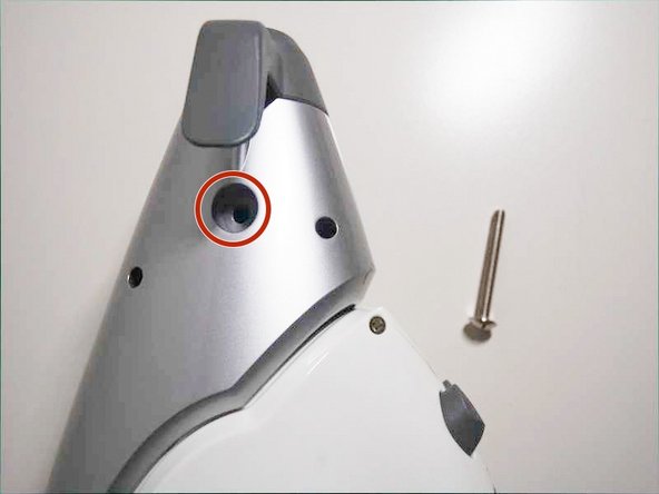

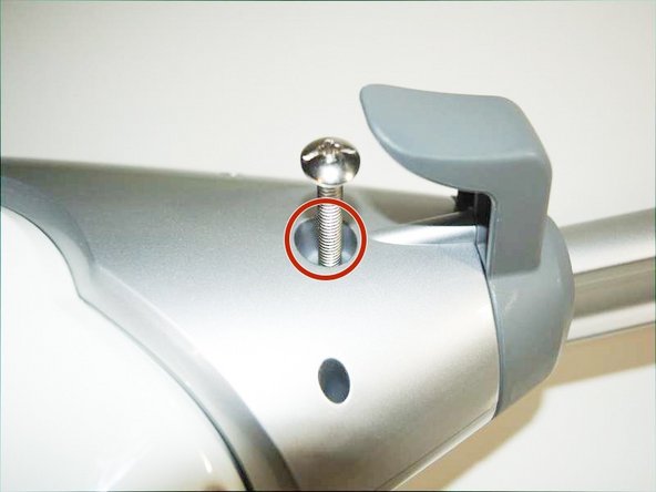

    • Place the Steam Pocket Mop face down on a flat surface.
    • Take note of the placement of the handle; the side labelled "front" should should face forward.
  3. Shark Lift-Away Professional Steam Pocket Mop Handle Replacement: crwdns2935265:03crwdnd2935265:01crwdnd2935265:03crwdne2935265:0 Shark Lift-Away Professional Steam Pocket Mop Handle Replacement: crwdns2935265:03crwdnd2935265:02crwdnd2935265:03crwdne2935265:0 Shark Lift-Away Professional Steam Pocket Mop Handle Replacement: crwdns2935265:03crwdnd2935265:03crwdnd2935265:03crwdne2935265:0
    • Remove the screw located underneath the cord holder.
    • Turn the screwdriver counter-clockwise to loosen the screw from its slot.
    • This is a long screw and will take time to remove.
To disassemble your device, follow these instructions in reverse order.
