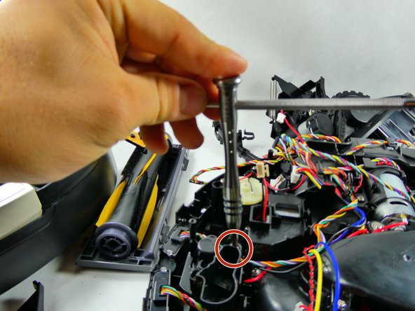

  20. Shark IQ AV993 Front Caster Wheel Replacement, Front Caster Wheel: crwdns2935265:020crwdnd2935265:01crwdnd2935265:02crwdne2935265:0 Shark IQ AV993 Front Caster Wheel Replacement, Front Caster Wheel: crwdns2935265:020crwdnd2935265:02crwdnd2935265:02crwdne2935265:0
    • Remove two 12 mm screws using a Phillips #1 screwdriver to loosen the front caster wheel.
    • Using some additional torque maybe required here, as these screws are held in very securely.
  21. Shark IQ AV993 Front Caster Wheel Replacement: crwdns2935265:021crwdnd2935265:01crwdnd2935265:01crwdne2935265:0
    • Upon unscrewing those two screws completely, the plastic housing should fall out. If the wheel was already falling out, then the clip is what is needed.
    • This red clip belongs on the end of the piece highlighted in orange. Once broken off, it may be advantageous to replace the whole unit, but with some bending of this metal ring, it can be maneuvered back onto this metal piece. If this is not an option, replacement is the proper route here.
