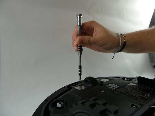

    • Unscrew the two 14 mm screws on the battery panel using a Phillips #1 screwdriver.
  2. Shark IQ AV993 Bumper Replacement: crwdns2935265:02crwdnd2935265:01crwdnd2935265:01crwdne2935265:0
    • Gently pull the white tabs on the battery straight upward.
    • There is a clip inserted into a plastic housing via wiring. Disconnect the battery by pressing in the clip.
    • Don't pull up on the battery too hard as a wire connects to the robot. Don't want to damage the wire here.
    • Remove the battery from the device.
  3. Shark IQ AV993 Bumper Replacement, Bumper: crwdns2935265:03crwdnd2935265:01crwdnd2935265:02crwdne2935265:0 Shark IQ AV993 Bumper Replacement, Bumper: crwdns2935265:03crwdnd2935265:02crwdnd2935265:02crwdne2935265:0
    • Remove the five 10 mm screws from the bottom of the device using a T15 Torx screwdriver.
  4. Shark IQ AV993 Bumper Replacement: crwdns2935265:04crwdnd2935265:01crwdnd2935265:01crwdne2935265:0
    • Pry both ends of the black piece to snap it out of place.
  5. Shark IQ AV993 Bumper Replacement: crwdns2935265:05crwdnd2935265:01crwdnd2935265:01crwdne2935265:0
    • Use both hands to lift the device.
    • The front bumper that is seated on the device will fall off.
    • This is completely normal, as the screws and the bottom holder are the only things holding the bumper in place.
