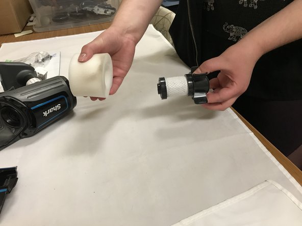

    • Squeeze the lever labeled “Clean Filters Monthly” and pull up on the plastic cover.
  2. Shark IONFlex 2X Top Filters Replacement: crwdns2935265:02crwdnd2935265:01crwdnd2935265:01crwdne2935265:0

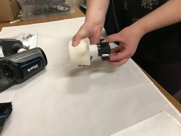

    • Grab the white foam filter inside and pull out.
  3. Shark IONFlex 2X Top Filters Replacement: crwdns2935265:03crwdnd2935265:01crwdnd2935265:03crwdne2935265:0 Shark IONFlex 2X Top Filters Replacement: crwdns2935265:03crwdnd2935265:02crwdnd2935265:03crwdne2935265:0 Shark IONFlex 2X Top Filters Replacement: crwdns2935265:03crwdnd2935265:03crwdnd2935265:03crwdne2935265:0
    • Grab the larger side of the black plastic ring on the side of the white filter, and separate the white foam filter from the inner filter.
