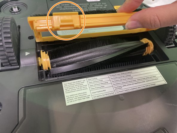

    • Remove the four 9.5mm Torx T6 bolts on the yellow brush frame.
    • Gently depress the two tabs on the frame, then lift the frame to remove it.

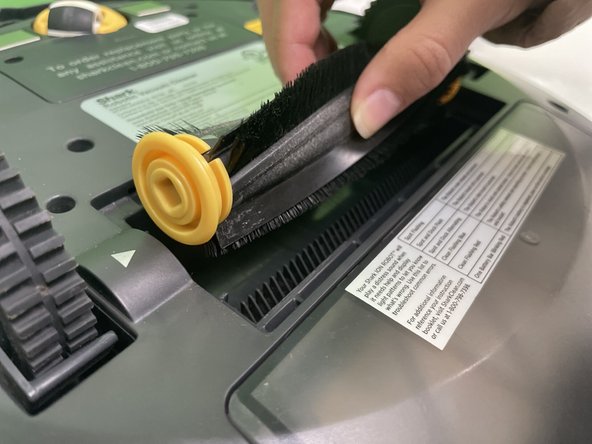

  4. Shark ION Robot 750 Motor Replacement: crwdns2935265:04crwdnd2935265:01crwdnd2935265:02crwdne2935265:0 Shark ION Robot 750 Motor Replacement: crwdns2935265:04crwdnd2935265:02crwdnd2935265:02crwdne2935265:0
    • Pick up the brush and remove it from the vacuum.
    • Push the brush to your right and lift it.

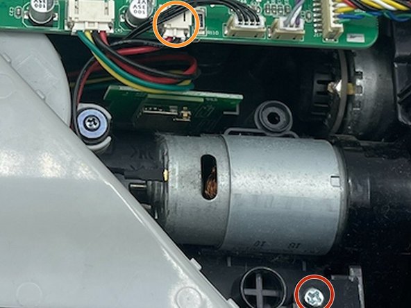

  7. Shark ION Robot 750 Motor Replacement, Motor: crwdns2935265:07crwdnd2935265:01crwdnd2935265:02crwdne2935265:0 Shark ION Robot 750 Motor Replacement, Motor: crwdns2935265:07crwdnd2935265:02crwdnd2935265:02crwdne2935265:0
    • Be sure to disconnect any source of power related to your vacuum for safety purposes.
    • Remove the bolt to detach the motor by using the Phillips #0 screwdriver.
    • The motor is connected to the motherboard by this group of wires. Gently pull on the white plug to disconnect the wires.
