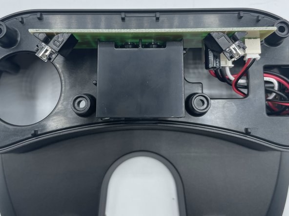

    • Remove the three Torx T6 screws on the underside of the charging dock.
    • Lift off the lower case.
  2. Shark ION Robot 750 Charging Dock Motherboard Replacement: crwdns2935265:02crwdnd2935265:01crwdnd2935265:01crwdne2935265:0
    • Using a Phillips #0 screwdriver, unscrew the four screws inside.
  3. Shark ION Robot 750 Charging Dock Motherboard Replacement: crwdns2935265:03crwdnd2935265:01crwdnd2935265:02crwdne2935265:0 Shark ION Robot 750 Charging Dock Motherboard Replacement: crwdns2935265:03crwdnd2935265:02crwdnd2935265:02crwdne2935265:0
    • Gently push in the tabs to remove the sensor housing.
  4. Shark ION Robot 750 Charging Dock Motherboard Replacement: crwdns2935265:04crwdnd2935265:01crwdnd2935265:01crwdne2935265:0
    • Unplug the two wires going into the motherboard, then gently lift the motherboard up and out of its slot.
