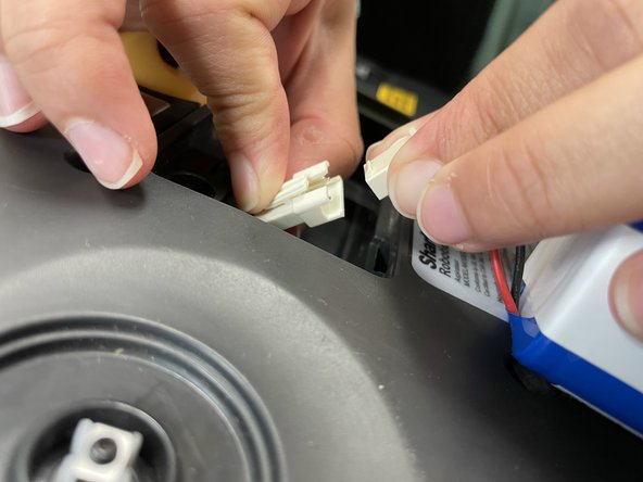

    • Make sure the device is completely powered off before working.
    • On the bottom of the vacuum, unscrew both sides of the vacuum cover using a Phillips screwdriver.
    • Gently lift and remove the cover.
  2. Shark ION Robot 750 Battery Replacement: crwdns2935265:02crwdnd2935265:01crwdnd2935265:02crwdne2935265:0 Shark ION Robot 750 Battery Replacement: crwdns2935265:02crwdnd2935265:02crwdnd2935265:02crwdne2935265:0
    • Grip both of the battery pull tabs and lift the battery out.
    • Be careful when lifting the battery out because it is still connected to the motherboard.
  3. Shark ION Robot 750 Battery Replacement: crwdns2935265:03crwdnd2935265:01crwdnd2935265:02crwdne2935265:0 Shark ION Robot 750 Battery Replacement: crwdns2935265:03crwdnd2935265:02crwdnd2935265:02crwdne2935265:0
    • To disconnect the battery, firmly squeeze down on the marked tabs, then pull the connector out of the socket.
