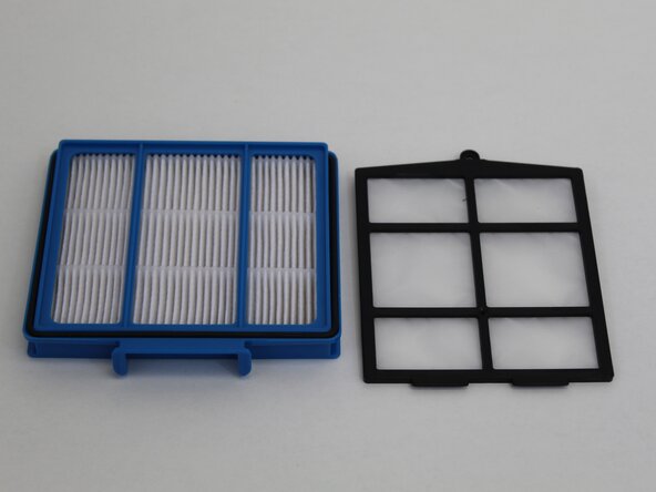

  2. Shark ION RV754 Filter Replacement: crwdns2935265:02crwdnd2935265:01crwdnd2935265:01crwdne2935265:0
    • Pull out the blue filter on the inside of the dust tray.
    • This filter is not attached to anything and should come out easily.

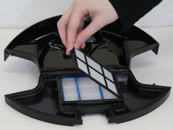

  3. Shark ION RV754 Filter Replacement: crwdns2935265:03crwdnd2935265:01crwdnd2935265:01crwdne2935265:0
    • To access the second filter, open the debris tray.
    • Hold the tray with two fingers at the indicated holes, and use your other hand to pull from the opposite side of the tray.
  4. Shark ION RV754 Filter Replacement: crwdns2935265:04crwdnd2935265:01crwdnd2935265:03crwdne2935265:0 Shark ION RV754 Filter Replacement: crwdns2935265:04crwdnd2935265:02crwdnd2935265:03crwdne2935265:0 Shark ION RV754 Filter Replacement: crwdns2935265:04crwdnd2935265:03crwdnd2935265:03crwdne2935265:0
    • Use a Phillips #0 screwdriver to remove the 7.3 mm screw securing the second filter.
    • Lift the filter out from the same side where you removed the screw.
