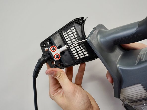

Shark Flex DuoClean Power Cord Replacement
  1. Shark Flex DuoClean Power Cord Replacement, Dust Cup: crwdns2935265:01crwdnd2935265:01crwdnd2935265:02crwdne2935265:0 Shark Flex DuoClean Power Cord Replacement, Dust Cup: crwdns2935265:01crwdnd2935265:02crwdnd2935265:02crwdne2935265:0
    • Squeeze Dust Cup release buttons on either side of the component.
    • Pull up to release Dust Cup.
  2. Shark Flex DuoClean Power Cord Replacement, Power Cord: crwdns2935265:02crwdnd2935265:01crwdnd2935265:02crwdne2935265:0 Shark Flex DuoClean Power Cord Replacement, Power Cord: crwdns2935265:02crwdnd2935265:02crwdnd2935265:02crwdne2935265:0
    • Remove the pre-motor filter with your hands.
  3. Shark Flex DuoClean Power Cord Replacement: crwdns2935265:03crwdnd2935265:01crwdnd2935265:01crwdne2935265:0
    • Remove the post-motor filter.
  4. Shark Flex DuoClean Power Cord Replacement: crwdns2935265:04crwdnd2935265:01crwdnd2935265:01crwdne2935265:0
    • Remove the two 15 mm screws by twisting counterclockwise with the T10 Torx screwdriver.
  5. Shark Flex DuoClean Power Cord Replacement: crwdns2935265:05crwdnd2935265:01crwdnd2935265:02crwdne2935265:0 Shark Flex DuoClean Power Cord Replacement: crwdns2935265:05crwdnd2935265:02crwdnd2935265:02crwdne2935265:0
    • Remove the two 12 mm screws by twisting counterclockwise with the T15 Torx screwdriver.
    • To fully remove the power cord, cut the wires using a wire cutter.
    • For reassembly, use the soldering guide in the Introduction.

I found with further dissasembly, uncrimping and recrimping the wiring loom saved having to add more connections.
