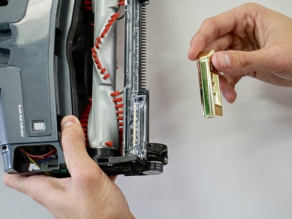

  7. Shark Flex DuoClean LED Headlight Replacement: crwdns2935265:07crwdnd2935265:01crwdnd2935265:02crwdne2935265:0 Shark Flex DuoClean LED Headlight Replacement: crwdns2935265:07crwdnd2935265:02crwdnd2935265:02crwdne2935265:0
    • Use the nylon spudger to pry the gold, plastic cover off of the headlights.
    • Prying off the cover too aggressively may cause it to break.
