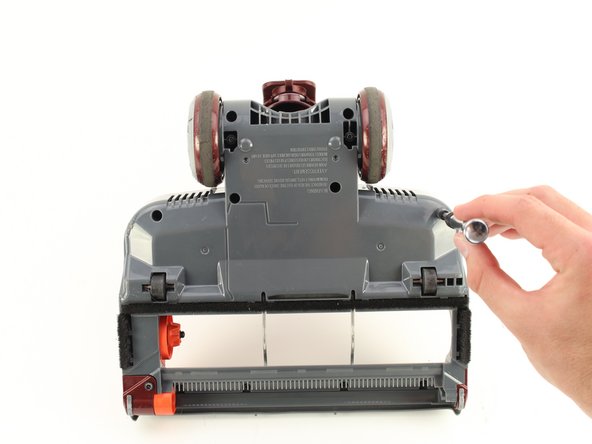

    • Use the T20 screwdriver to remove the four 17 mm screws by turning counterclockwise.
  5. Shark DuoClean Powered Lift-Away Speed Drive Belt Replacement: crwdns2935265:05crwdnd2935265:01crwdnd2935265:02crwdne2935265:0 Shark DuoClean Powered Lift-Away Speed Drive Belt Replacement: crwdns2935265:05crwdnd2935265:02crwdnd2935265:02crwdne2935265:0

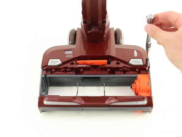

    • Use the T20 screwdriver to remove the six 19 mm screws by turning counterclockwise.
    • Use the T20 screwdriver to remove the one 12 mm screw by turning counterclockwise.
    • Use the T10 screwdriver to remove the four 14 mm screws by turning counterclockwise.

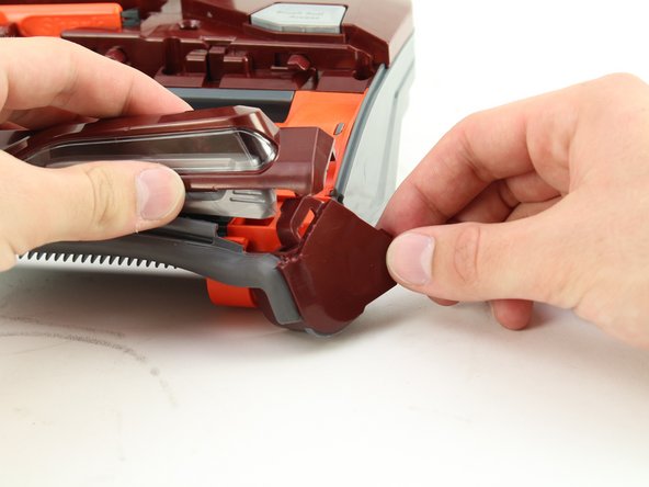

    • Use the spudger tool to pry off the red plastic corner cap.
    • Remove the LED headlight casing by pulling up on the casing and out on the corner cap at the same time.

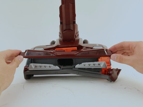

    • Use the spudger to detach the orange drive belt compartment from the vacuum.
    • Remove the orange drive belt compartment from the vacuum by lifting it upwards.
