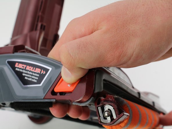

Shark DuoClean Powered Lift-Away Speed Brushroll Replacement
  1. Shark DuoClean Powered Lift-Away Speed Brushroll Replacement, Brushroll: crwdns2935265:01crwdnd2935265:01crwdnd2935265:03crwdne2935265:0 Shark DuoClean Powered Lift-Away Speed Brushroll Replacement, Brushroll: crwdns2935265:01crwdnd2935265:02crwdnd2935265:03crwdne2935265:0 Shark DuoClean Powered Lift-Away Speed Brushroll Replacement, Brushroll: crwdns2935265:01crwdnd2935265:03crwdnd2935265:03crwdne2935265:0
    • Press the two Brush Roll Access buttons down at the same time to detach the cover.
    • Pull the cover off of the vacuum by lifting it up.
  2. Shark DuoClean Powered Lift-Away Speed Brushroll Replacement: crwdns2935265:02crwdnd2935265:01crwdnd2935265:02crwdne2935265:0 Shark DuoClean Powered Lift-Away Speed Brushroll Replacement: crwdns2935265:02crwdnd2935265:02crwdnd2935265:02crwdne2935265:0
    • Pull up on the Pull Tab to remove the large brush roll.
  3. Shark DuoClean Powered Lift-Away Speed Brushroll Replacement: crwdns2935265:03crwdnd2935265:01crwdnd2935265:02crwdne2935265:0 Shark DuoClean Powered Lift-Away Speed Brushroll Replacement: crwdns2935265:03crwdnd2935265:02crwdnd2935265:02crwdne2935265:0
    • Press the Eject Roller button to detach the small roller.
    • Pull the roller away from the vacuum to remove it.
