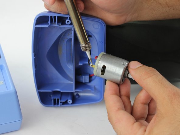

  5. Shark Cordless Pet Perfect Front Motor  Replacement, Front Motor: crwdns2935265:05crwdnd2935265:01crwdnd2935265:02crwdne2935265:0 Shark Cordless Pet Perfect Front Motor  Replacement, Front Motor: crwdns2935265:05crwdnd2935265:02crwdnd2935265:02crwdne2935265:0
    • Remove the solder from both motor terminals.

Well done, Ashley! You might want to note that using a solder remover is helpful.
