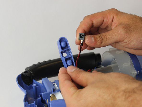

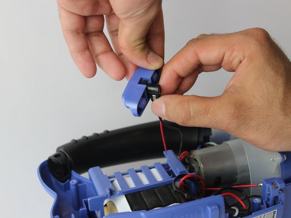

Shark Cordless Pet Perfect Charging Port Replacement
  1. Shark Cordless Pet Perfect Charging Port Replacement, Charging Port: crwdns2935265:01crwdnd2935265:01crwdnd2935265:03crwdne2935265:0 Shark Cordless Pet Perfect Charging Port Replacement, Charging Port: crwdns2935265:01crwdnd2935265:02crwdnd2935265:03crwdne2935265:0 Shark Cordless Pet Perfect Charging Port Replacement, Charging Port: crwdns2935265:01crwdnd2935265:03crwdnd2935265:03crwdne2935265:0
    • Remove the dust cup container from the motor housing.
  2. Shark Cordless Pet Perfect Charging Port Replacement: crwdns2935265:02crwdnd2935265:01crwdnd2935265:03crwdne2935265:0 Shark Cordless Pet Perfect Charging Port Replacement: crwdns2935265:02crwdnd2935265:02crwdnd2935265:03crwdne2935265:0 Shark Cordless Pet Perfect Charging Port Replacement: crwdns2935265:02crwdnd2935265:03crwdnd2935265:03crwdne2935265:0
    • Remove the five 14mm screws with the PH 2 bit. Once all the screws are removed, pull one part of the housing away from the other.
  3. Shark Cordless Pet Perfect Charging Port Replacement: crwdns2935265:03crwdnd2935265:01crwdnd2935265:03crwdne2935265:0 Shark Cordless Pet Perfect Charging Port Replacement: crwdns2935265:03crwdnd2935265:02crwdnd2935265:03crwdne2935265:0 Shark Cordless Pet Perfect Charging Port Replacement: crwdns2935265:03crwdnd2935265:03crwdnd2935265:03crwdne2935265:0
    • Pull the charging port mount away from the housing. Once separated, pull the the charging port out of the mount to access the charging port itself.
  4. Shark Cordless Pet Perfect Charging Port Replacement: crwdns2935265:04crwdnd2935265:01crwdnd2935265:02crwdne2935265:0 Shark Cordless Pet Perfect Charging Port Replacement: crwdns2935265:04crwdnd2935265:02crwdnd2935265:02crwdne2935265:0
