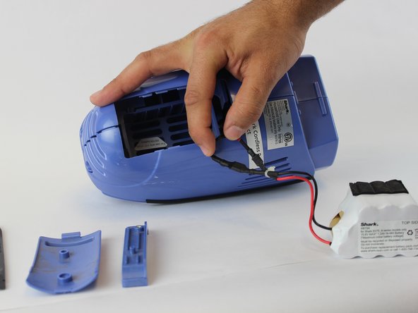

    • Remove the Dust Cap Container then remove the 7.5mm screw (with the PH2 Bit) from the battery cover.
    • Using a black spudger pry open the cover, and remove the cover plate.
  2. Shark Cordless Pet Perfect Battery Replacement: crwdns2935265:02crwdnd2935265:01crwdnd2935265:02crwdne2935265:0 Shark Cordless Pet Perfect Battery Replacement: crwdns2935265:02crwdnd2935265:02crwdnd2935265:02crwdne2935265:0
    • Once the battery cover is removed slide the battery mount upwards and pull it out.
  3. Shark Cordless Pet Perfect Battery Replacement: crwdns2935265:03crwdnd2935265:01crwdnd2935265:03crwdne2935265:0 Shark Cordless Pet Perfect Battery Replacement: crwdns2935265:03crwdnd2935265:02crwdnd2935265:03crwdne2935265:0 Shark Cordless Pet Perfect Battery Replacement: crwdns2935265:03crwdnd2935265:03crwdnd2935265:03crwdne2935265:0
    • Pull out the battery and then disconnect the battery at the quick disconnects.
