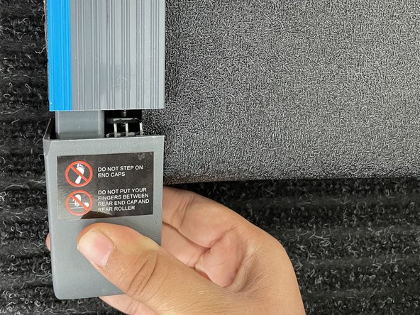

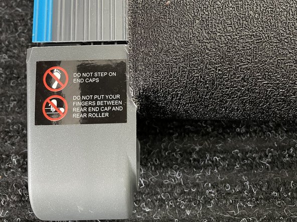

    • In order to locate the roller adjustment bolts, try locating the rear left cover and rear right cover.
  4. SereneLife Treadmill SLFTRD20 Belt Adjustment: crwdns2935265:04crwdnd2935265:01crwdnd2935265:03crwdne2935265:0 SereneLife Treadmill SLFTRD20 Belt Adjustment: crwdns2935265:04crwdnd2935265:02crwdnd2935265:03crwdne2935265:0 SereneLife Treadmill SLFTRD20 Belt Adjustment: crwdns2935265:04crwdnd2935265:03crwdnd2935265:03crwdne2935265:0
    • Remove the attached rear left and right covers from the treadmill.

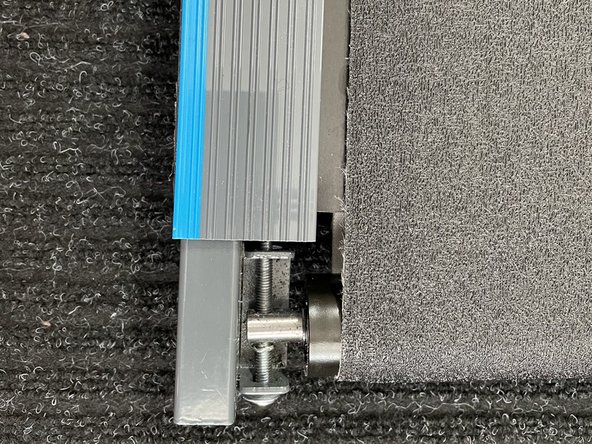

    • After removing the rear covers, you'll be able to see the adjustment bolts.

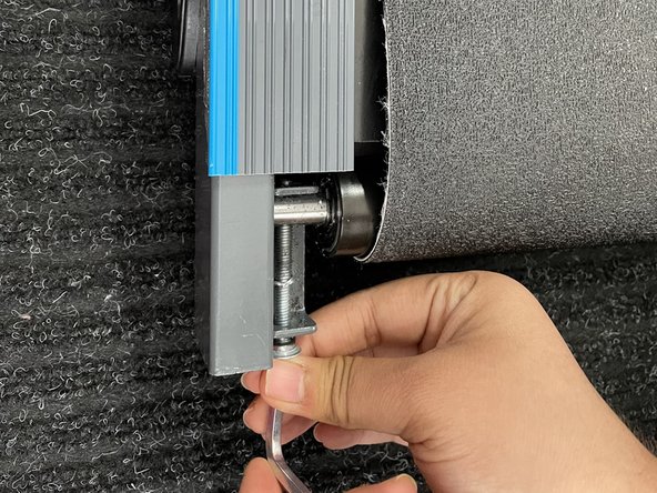

    • Before we begin it's important to determine which side the belt is shifting towards.
    • If the belt is shifting to the right, then turn the right adjustment bolt to turn 1/4 clockwise. If the belt is shifting to the left, then turn the left adjustment bolt to turn 1/4 clockwise.
    • Place the Allen wrench in the left rear roller bolt.
    • Turn the left roller bolt adjustment to turn one-fourth clockwise.
    • Now stop and wait for the belt to begin to center itself.
    • You must wait for the belt to re-center between each adjustment to ensure that you do not overcorrect the belt.

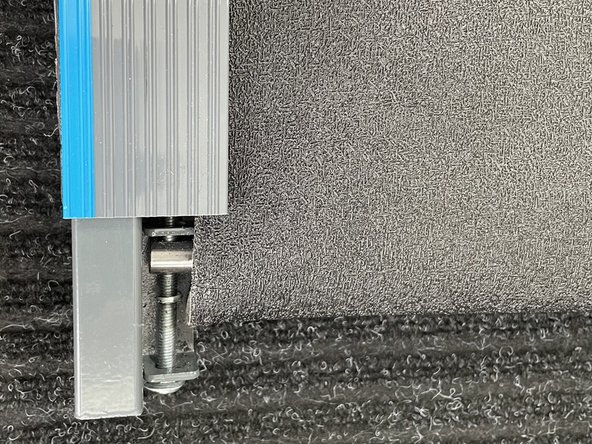

    • Place the Allen wrench in the left roller bolt and turn it 1/4 clockwise to tighten the belt.
    • Repeat on the right side of the roller bolt in the same way.
