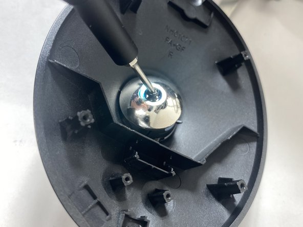

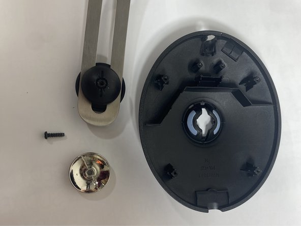

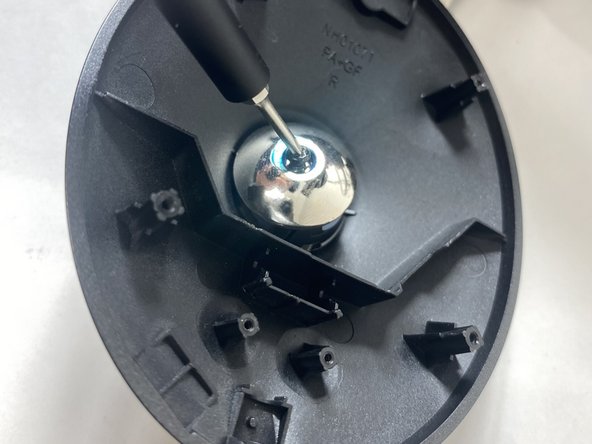

    • Remove the four 8mm screws on the ear cup using a #000 Phillips screwdriver to reveal the motherboard.
  4. Sennheiser Momentum Wireless M2 AEBT Adjustable Sliding Hinges Replacement: crwdns2935265:04crwdnd2935265:01crwdnd2935265:03crwdne2935265:0 Sennheiser Momentum Wireless M2 AEBT Adjustable Sliding Hinges Replacement: crwdns2935265:04crwdnd2935265:02crwdnd2935265:03crwdne2935265:0 Sennheiser Momentum Wireless M2 AEBT Adjustable Sliding Hinges Replacement: crwdns2935265:04crwdnd2935265:03crwdnd2935265:03crwdne2935265:0

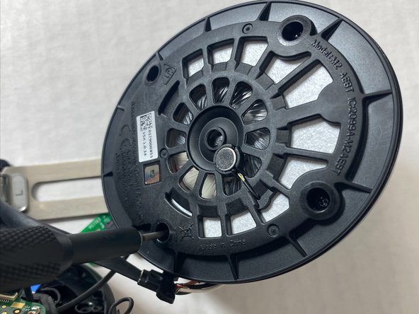

    • On one half of the ear cup that was previously removed, there will be located a motherboard. On the other half there will be a coupler holding the cup to the hinge and allowing it to move in a 360 degree manner. Remove this coupler by unscrewing the 10mm screw with the same #000 Phillips screwdriver.

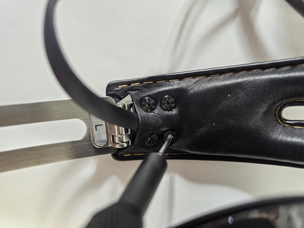

    • On the leather part of the headset, four 6mm Torx screws need to be removed using a T6H Torx screwdriver.

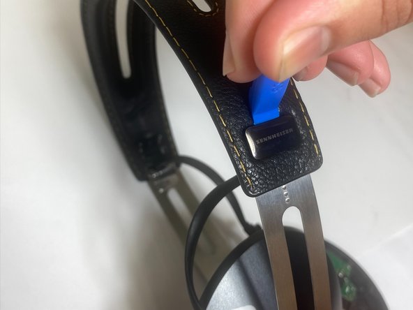

    • On the other side of the 6mm torx screws, there is a nameplate that needs to be pried off using a pry tool.
