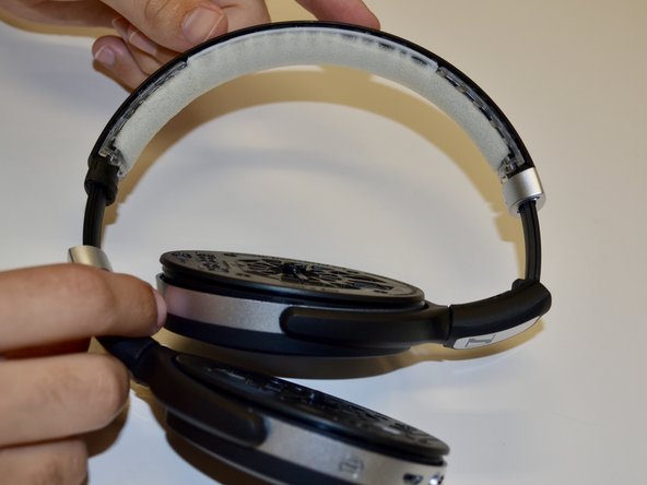

    • Extend the headphones by pulling the headband away from the base of the headphones.
    • Do this to both the right and left sides of the headphones.
  2. Sennheiser HD 4.50 Headband Pad Replacement: crwdns2935265:02crwdnd2935265:01crwdnd2935265:03crwdne2935265:0 Sennheiser HD 4.50 Headband Pad Replacement: crwdns2935265:02crwdnd2935265:02crwdnd2935265:03crwdne2935265:0 Sennheiser HD 4.50 Headband Pad Replacement: crwdns2935265:02crwdnd2935265:03crwdnd2935265:03crwdne2935265:0
    • Use a Phillips #000 screwdriver to remove the two screws on the silver piece on either edge of the headband.
    • Make sure to do this to both the right and left sides of the headphones.
    • After removing the screws, slide both silver pieces down.
  3. Sennheiser HD 4.50 Headband Pad Replacement: crwdns2935265:03crwdnd2935265:01crwdnd2935265:02crwdne2935265:0 Sennheiser HD 4.50 Headband Pad Replacement: crwdns2935265:03crwdnd2935265:02crwdnd2935265:02crwdne2935265:0
    • Grasp the headband pad firmly with your pointer finger and thumb and gently pull the pad away from the headband until the pad is fully removed.
    • You may need to apply adhesive when sticking the replacement headband pad back to the headband.
