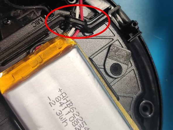

    • Locate the side designation on the headband-earpiece junction.
    • The battery is on the left side.
    • The motherboard is on the right side.
  2. Sennheiser HD 4.50 Battery Replacement: crwdns2935265:02crwdnd2935265:01crwdnd2935265:03crwdne2935265:0 Sennheiser HD 4.50 Battery Replacement: crwdns2935265:02crwdnd2935265:02crwdnd2935265:03crwdne2935265:0 Sennheiser HD 4.50 Battery Replacement: crwdns2935265:02crwdnd2935265:03crwdnd2935265:03crwdne2935265:0
  3. Sennheiser HD 4.50 Battery Replacement: crwdns2935265:03crwdnd2935265:01crwdnd2935265:03crwdne2935265:0 Sennheiser HD 4.50 Battery Replacement: crwdns2935265:03crwdnd2935265:02crwdnd2935265:03crwdne2935265:0 Sennheiser HD 4.50 Battery Replacement: crwdns2935265:03crwdnd2935265:03crwdnd2935265:03crwdne2935265:0
    • Use a Phillips #00 screwdriver to remove the four 10 mm screws holding the ear cup cover in place.
    • Use an opening tool to pry open the cover.
    • Remove the cover.
  4. Sennheiser HD 4.50 Battery Replacement: crwdns2935265:04crwdnd2935265:01crwdnd2935265:01crwdne2935265:0
    • Use a spudger to pry the battery from the plastic case.
    • The battery is held down by a strong adhesive, so it will give resistance. You can apply a few drops of high concentration (>90%) isopropyl alcohol to the base of the battery to loosen it.
  5. Sennheiser HD 4.50 Battery Replacement: crwdns2935265:05crwdnd2935265:01crwdnd2935265:02crwdne2935265:0 Sennheiser HD 4.50 Battery Replacement: crwdns2935265:05crwdnd2935265:02crwdnd2935265:02crwdne2935265:0
    • Using tweezers, pull the white battery connector upwards out of its socket.
    • Remove the battery.
    • Silicone sealant and foam tape has been used to segregate the two compartments. This will rip when the cable is removed. It can be replaced with fresh silicone if desired.

Hello ! Thanks for the tuto. Do you know where to buy the battery ?
Fren6 - crwdns2934203:0crwdne2934203:0
You can search with the part number(Shown in the photo) : AHB622540N1/AHB622540N01.
Santanu Ghosal - crwdns2934203:0crwdne2934203:0

This was pretty straightforward, but in opening the cap one of the tiny soldered wires pulled off the pad. It's so tiny that I don't have much hope of soldering it back. Any other way to reattach it? I put it back together anyways and now the right cup works fine, but the left is dead. I recommend a warning here about the little wires, if nothing else.
