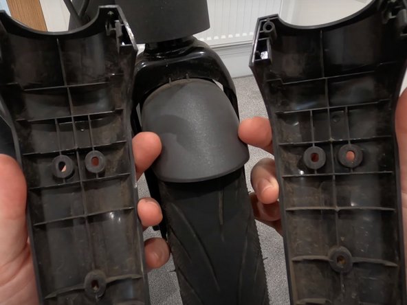

  3. Segway Ninebot Max Front Tire Repacement: crwdns2935265:03crwdnd2935265:01crwdnd2935265:02crwdne2935265:0 Segway Ninebot Max Front Tire Repacement: crwdns2935265:03crwdnd2935265:02crwdnd2935265:02crwdne2935265:0
    • Snap the covers away from the scooter from both sides.
    • Remove the covers slowly and steadily to avoid breaking it.

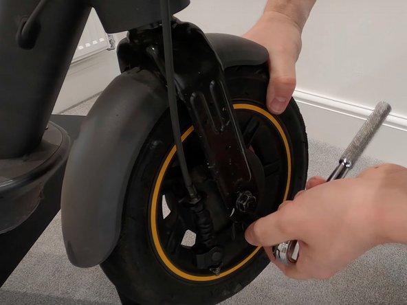

    • To detach the brake, use a 10 mm Allen wrench to remove the bolt from the tire that is attached with the brake.
  5. Segway Ninebot Max Front Tire Repacement: crwdns2935265:05crwdnd2935265:01crwdnd2935265:02crwdne2935265:0 Segway Ninebot Max Front Tire Repacement: crwdns2935265:05crwdnd2935265:02crwdnd2935265:02crwdne2935265:0

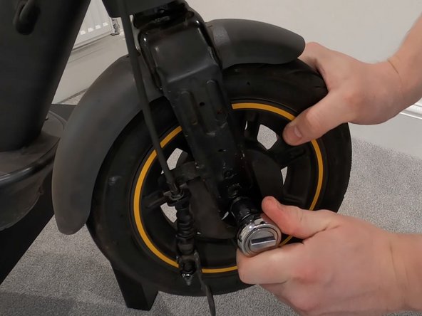

    • Use a 15 mm socket wrench to remove 15mm bolt from the tire of the scooter on both sides of the front wheel.
  6. Segway Ninebot Max Front Tire Repacement: crwdns2935265:06crwdnd2935265:01crwdnd2935265:01crwdne2935265:0
    • Pull down the tire and remove it from the frame.
