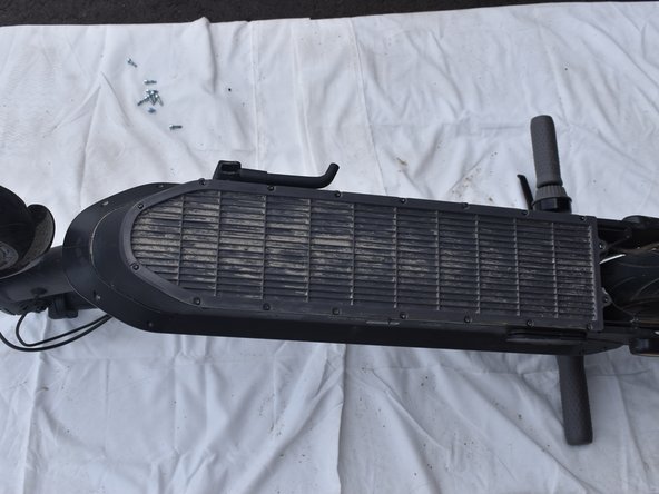

    • Flip the scooter upside down and unscrew the 18 screws holding the base plate using a Security Torx T15 screwdriver.
