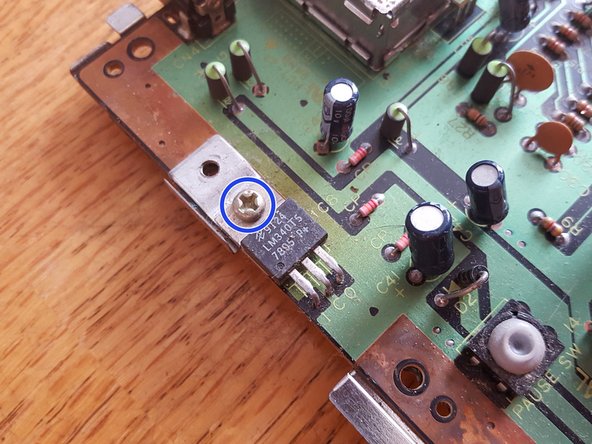

    • Now we have a complete view of the motherboard, thus coming to the last step.
    • For this step you only need to remove 3 remaining screws.
    • 2 screws on the connector.
    • There's 1 shorter screw as previously with the RF shield. This small screw keeps the voltage regulator in place.
  8. Sega Master System II Motherboard Replacement: crwdns2935265:08crwdnd2935265:01crwdnd2935265:01crwdne2935265:0
    • When you've disassembled everything, it should look like this.
    • Once you've got the replacement board, just follow this guide in reverse order.
