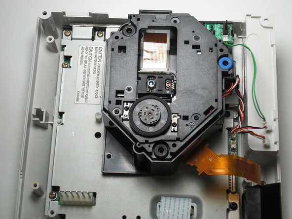

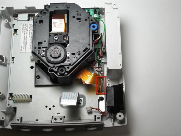

    1. Sega Dreamcast GD-ROM Replacement, GD-ROM: crwdns2935265:05crwdnd2935265:01crwdnd2935265:02crwdne2935265:0 Sega Dreamcast GD-ROM Replacement, GD-ROM: crwdns2935265:05crwdnd2935265:02crwdnd2935265:02crwdne2935265:0
      • Detach the orange cable by giving it a gentle pull while wiggling the cable back and forth until it loosens from the logic board.
    2. Sega Dreamcast GD-ROM Replacement: crwdns2935265:06crwdnd2935265:01crwdnd2935265:02crwdne2935265:0 Sega Dreamcast GD-ROM Replacement: crwdns2935265:06crwdnd2935265:02crwdnd2935265:02crwdne2935265:0
      • Detach the cables by gently pulling the three GD-ROM cables to remove them from the logic board.

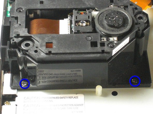

    3. Sega Dreamcast GD-ROM Replacement: crwdns2935265:07crwdnd2935265:01crwdnd2935265:02crwdne2935265:0 Sega Dreamcast GD-ROM Replacement: crwdns2935265:07crwdnd2935265:02crwdnd2935265:02crwdne2935265:0
      • Remove the two black 12mm Philips #02 screws located on the left side of the GD-ROM bracket.
      • The console is rotated 90 degrees counter-clockwise in the first photo. The second photo depicts the normal position.
    4. Sega Dreamcast GD-ROM Replacement: crwdns2935265:08crwdnd2935265:01crwdnd2935265:02crwdne2935265:0 Sega Dreamcast GD-ROM Replacement: crwdns2935265:08crwdnd2935265:02crwdnd2935265:02crwdne2935265:0
      • When lifting the GD-ROM, be careful that the top half of the casing does not detached from its base.

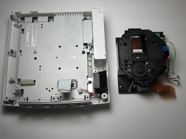

      • Remove the GD-ROM by gently lifting it from its base.
    1. Sega Dreamcast GD-ROM Replacement, GD-ROM: crwdns2935265:09crwdnd2935265:01crwdnd2935265:02crwdne2935265:0 Sega Dreamcast GD-ROM Replacement, GD-ROM: crwdns2935265:09crwdnd2935265:02crwdnd2935265:02crwdne2935265:0
      • Replace the bad GD-ROM drive with a functional one.
    2. Sega Dreamcast GD-ROM Replacement: crwdns2935265:010crwdnd2935265:01crwdnd2935265:02crwdne2935265:0 Sega Dreamcast GD-ROM Replacement: crwdns2935265:010crwdnd2935265:02crwdnd2935265:02crwdne2935265:0

    3. Sega Dreamcast GD-ROM Replacement: crwdns2935265:011crwdnd2935265:01crwdnd2935265:03crwdne2935265:0 Sega Dreamcast GD-ROM Replacement: crwdns2935265:011crwdnd2935265:02crwdnd2935265:03crwdne2935265:0 Sega Dreamcast GD-ROM Replacement: crwdns2935265:011crwdnd2935265:03crwdnd2935265:03crwdne2935265:0
      • Connect the three GD-ROM cables to the logic board.
      • Connect the GD-ROM data ribbon to the logic board.

If only it was that simple Sega screwed U.K gamers over with the fact we have to buy totally new consoles due to the wires of the disk drive being soldered in rather than clipped in.
Anthony Salmon - crwdns2934203:0crwdne2934203:0 crwdns2950251:0crwdne2950251:0
My HKT-3020 console, NTSC-U revision 1, manufactured in Japan during 4/2000, does not have the orange cable shown in step 5. I was able to skip steps 5 and 6, and for step 7 I had to remove 3 screws, not 2. My GD-ROM drive came as an assembly, mounted on a metal plate; the entire assembly simply lowers into a connector port. After removing the screws, I just had to gently wiggle it up and out of the port, then lower the replacement assembly into the same port, and replace the 3 screws.
