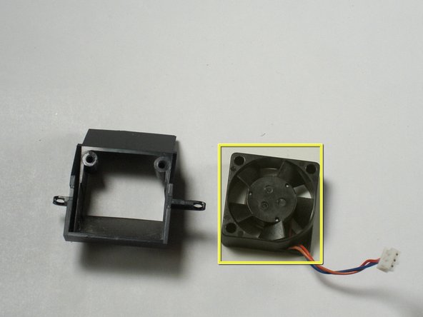

  5. Sega Dreamcast Fan Replacement, Fan: crwdns2935265:05crwdnd2935265:01crwdnd2935265:01crwdne2935265:0
    • Remove the white fan header by gently pulling it away from from the controller port.
    • The white fan header may already be detached if you have completed the Controller Port Disassembly Guide.
  6. Sega Dreamcast Fan Replacement: crwdns2935265:06crwdnd2935265:01crwdnd2935265:01crwdne2935265:0
    • Remove the two 8.5mm Philips #00 screws from the fan bracket.
  7. Sega Dreamcast Fan Replacement: crwdns2935265:07crwdnd2935265:01crwdnd2935265:02crwdne2935265:0 Sega Dreamcast Fan Replacement: crwdns2935265:07crwdnd2935265:02crwdnd2935265:02crwdne2935265:0
    • Remove the two 17.5mm Philips #00 screws from the fan bracket.
    • Remove the fan from the bracket.
  8. Sega Dreamcast Fan Replacement, Fan: crwdns2935265:08crwdnd2935265:01crwdnd2935265:02crwdne2935265:0 Sega Dreamcast Fan Replacement, Fan: crwdns2935265:08crwdnd2935265:02crwdnd2935265:02crwdne2935265:0
    • Connect the new fan to the fan bracket using two 17.5mm Philips #00 screws.
    • Replace the fan bracket in the Dreamcast using two 8.5mm Philips #00 screws.
