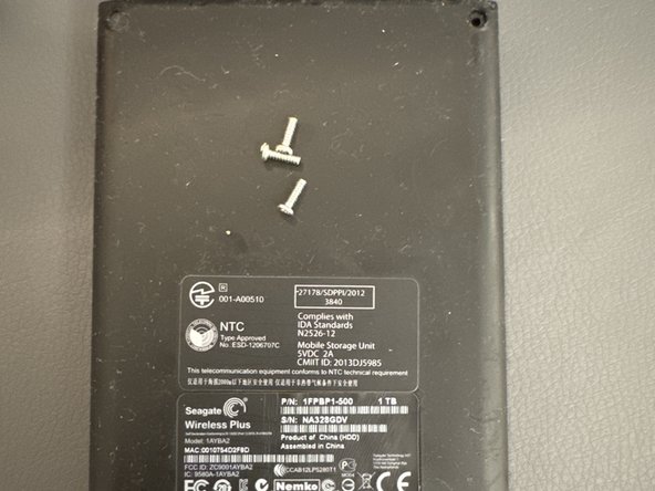

Using the knife and tweezers, take out the feet (BE CAREFUL WITH THE KNIFE)
Then, take out the screws, using the PH0 screwdriver (there are only 3 screws under the feet)

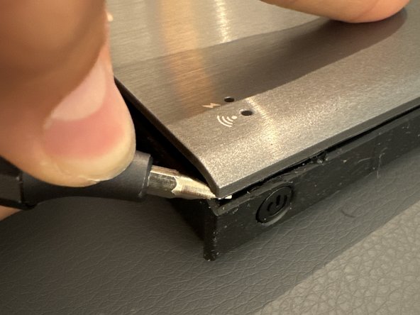

Use the puck to open it a little (so the flat screw could fit)
Then, using the flat head, open that side (you will hear a click or multiple clicks when you will do it)
Repeat these steps until you will open up the hard drive
