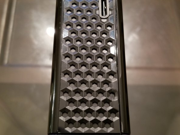

  1. Seagate Backup Plus Hub Teardown, Overview: crwdns2935265:01crwdnd2935265:01crwdnd2935265:01crwdne2935265:0
    • Above you will find a picture of the fully disassembled casing on the outside of the bay, (the board inside is not shown). The entire case is held togeter with snaps. These ones are particularly nasty and I found I could only prevent a few from breaking when opening the case even when using the gutar picks from the ifixit pro tech toolkit

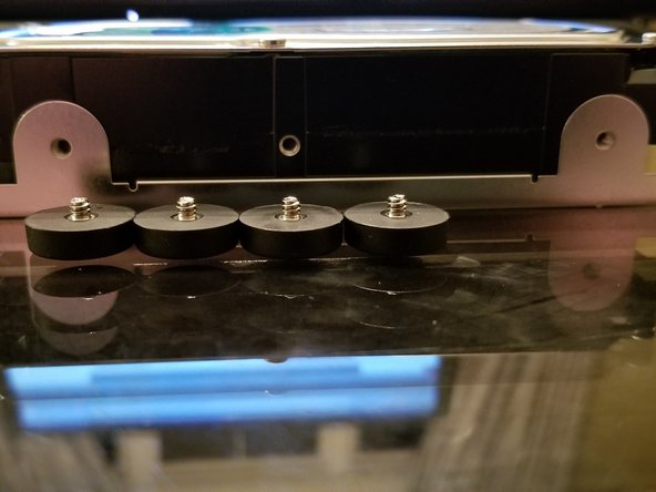

  11. Seagate Backup Plus Hub Teardown, Remove the mounting screws: crwdns2935265:011crwdnd2935265:01crwdnd2935265:02crwdne2935265:0 Seagate Backup Plus Hub Teardown, Remove the mounting screws: crwdns2935265:011crwdnd2935265:02crwdnd2935265:02crwdne2935265:0
    • The rubber pieces that were removed before, covered up four screws total (2 on each side). (See Picture 1) Remove those screws using your #1 Philips head screwdriver.
    • After this, the drive is free from its mounting screws. I put the mounting screws into the rubber feet to avoid losing them. (picture 2)
