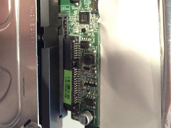

    • Peel the foil back gently. You'll find a white square (no idea what its for!) remove this (its not stuck down). Don't pull the foil off completely.

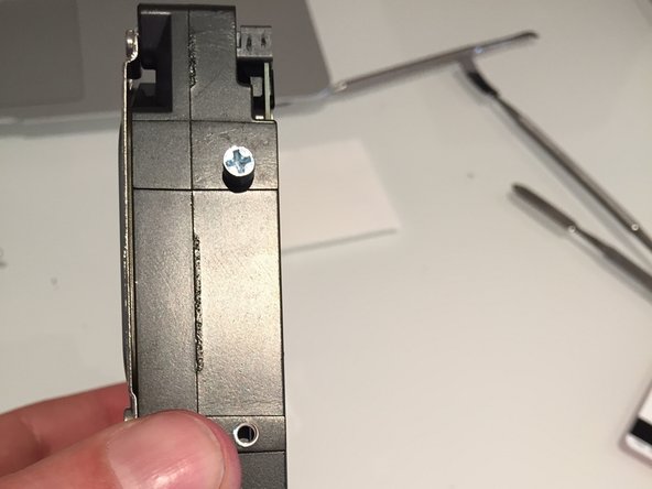

    • Remove the screw on the underside of the drive, it holds the SATA to USB adaptor in place.
    • Turn the drive over now the screw is removed and you should be able to gently pull the SATA to USB adaptor away from the Hard Drive.
  5. Seagate 5TB External USB3 Teardown: crwdns2935265:05crwdnd2935265:01crwdnd2935265:02crwdne2935265:0 Seagate 5TB External USB3 Teardown: crwdns2935265:05crwdnd2935265:02crwdnd2935265:02crwdne2935265:0
    • Dismantled parts of the SATA to USB and the Hard drive.

Later models don’t have the white square and the foil is only wrapped around a from the controller, over the part of the board where the SATA connector is, and a little bit of the drive. “Minimum Viable EMI protection” would be my guess :-) The rest of the process is unchanged.
