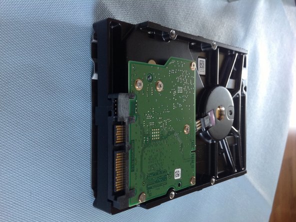

  3. Seagate 3TB Expansion Desktop Drive Teardown: crwdns2935265:03crwdnd2935265:01crwdnd2935265:01crwdne2935265:0
    • Gently pull the sides slightly and the drive will lift out
  4. Seagate 3TB Expansion Desktop Drive Teardown: crwdns2935265:04crwdnd2935265:01crwdnd2935265:03crwdne2935265:0 Seagate 3TB Expansion Desktop Drive Teardown: crwdns2935265:04crwdnd2935265:02crwdnd2935265:03crwdne2935265:0 Seagate 3TB Expansion Desktop Drive Teardown: crwdns2935265:04crwdnd2935265:03crwdnd2935265:03crwdne2935265:0
    • Pull the rubber screw covers off, these are mounted with a little glue and came off easily
    • Remove all four screws with the philips screwdriver

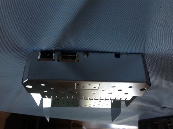

  5. Seagate 3TB Expansion Desktop Drive Teardown: crwdns2935265:05crwdnd2935265:01crwdnd2935265:03crwdne2935265:0 Seagate 3TB Expansion Desktop Drive Teardown: crwdns2935265:05crwdnd2935265:02crwdnd2935265:03crwdne2935265:0 Seagate 3TB Expansion Desktop Drive Teardown: crwdns2935265:05crwdnd2935265:03crwdnd2935265:03crwdne2935265:0
    • Slide drive out of metal caddy (do not lift)
    • You will now have a SATA Hard Drive and the caddy separate

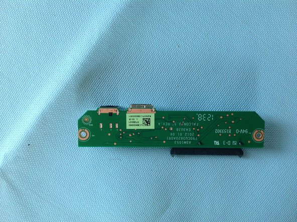

  6. Seagate 3TB Expansion Desktop Drive Teardown: crwdns2935265:06crwdnd2935265:01crwdnd2935265:03crwdne2935265:0 Seagate 3TB Expansion Desktop Drive Teardown: crwdns2935265:06crwdnd2935265:02crwdnd2935265:03crwdne2935265:0 Seagate 3TB Expansion Desktop Drive Teardown: crwdns2935265:06crwdnd2935265:03crwdnd2935265:03crwdne2935265:0
    • From the bottom of the caddy there are two black screws
    • With the Philips screwdriver you can remove these
    • Pull the circuit board gently and evenly to remove it
