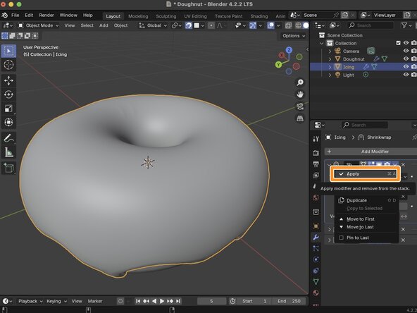

    1. Sculpting, Using Shrinkwrap: crwdns2935265:018crwdnd2935265:01crwdnd2935265:03crwdne2935265:0 Sculpting, Using Shrinkwrap: crwdns2935265:018crwdnd2935265:02crwdnd2935265:03crwdne2935265:0 Sculpting, Using Shrinkwrap: crwdns2935265:018crwdnd2935265:03crwdnd2935265:03crwdne2935265:0
      • Before we continue with sculpting it is important to resolve any issues where the mesh of our Icing separate from the mesh of our Doughnut. We can do this using the Shrink Wrap Modifier.
      • Shrinkwrap Modifier: This enables an object's geometry to conform to the surface of another object, effectively "wrapping" or "shrinking" it onto the target mesh. This modifier is particularly useful for tasks such as fitting clothing onto characters, projecting decals onto surfaces, or aligning objects to complex terrains.
      • Under our Icing's Modifiers tab, click on Add Modifier, and under Deform choose Shrinkwrap.
      • Once our Shrinkwrap modifier has been added, we're going to have to set our Target to our Doughnut.
    2. Sculpting, Using Shrinkwrap (Continued): crwdns2935265:019crwdnd2935265:01crwdnd2935265:03crwdne2935265:0 Sculpting, Using Shrinkwrap (Continued): crwdns2935265:019crwdnd2935265:02crwdnd2935265:03crwdne2935265:0 Sculpting, Using Shrinkwrap (Continued): crwdns2935265:019crwdnd2935265:03crwdnd2935265:03crwdne2935265:0
      • Drag your Shrinkwrap modifier to the top of the modifier stack. This will fix any visial artifacting that we experienced.
      • The modifier stack operates sequentially from top to bottom, meaning each modifier's effect is applied in order, influencing the subsequent modifiers down the list. This order is crucial because, as seen, the outcome of one modifier can significantly impact how the following modifiers affect the object.
      • Click on the Down Arrow on our Shrinkwrap modifier and click apply to remove the modifier from our stack.
      • Looking at our Icing's mesh, we can see that it is properly conformed to your Doughnut.

    7. Sculpting, Comparning our Unculpted model and our Sculpted Model: crwdns2935265:025crwdnd2935265:01crwdnd2935265:01crwdne2935265:0
      • Here we see our unsculpted model compaired to our sculpted model. We can see how adding subblte variations to our Icing can greatly improve the visual aspect of our model.
Congratulations! You've just sculpted your model to add additional visual variation to our model.
