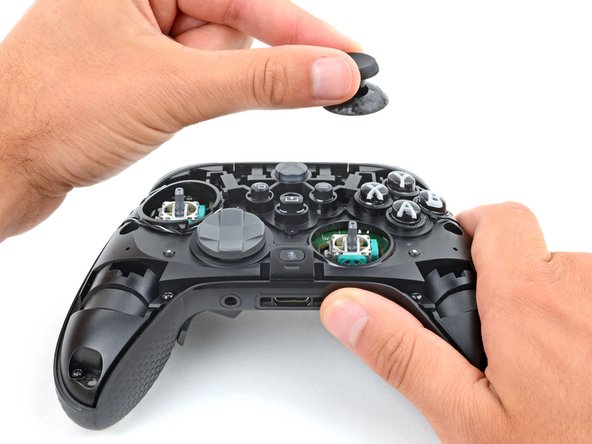

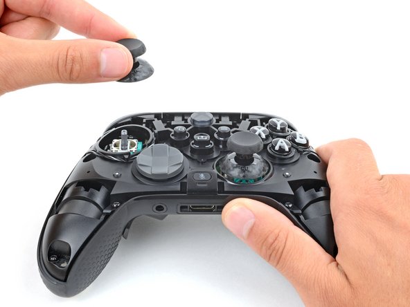

  3. Scuf Instinct Pro Thumbstick Covers Replacement, Remove the thumbstick covers: crwdns2935265:03crwdnd2935265:01crwdnd2935265:03crwdne2935265:0 Scuf Instinct Pro Thumbstick Covers Replacement, Remove the thumbstick covers: crwdns2935265:03crwdnd2935265:02crwdnd2935265:03crwdne2935265:0 Scuf Instinct Pro Thumbstick Covers Replacement, Remove the thumbstick covers: crwdns2935265:03crwdnd2935265:03crwdnd2935265:03crwdne2935265:0
    • Firmly secure the controller with one hand, and use your other hand to lift the thumbstick covers straight off their modules.
    • This requires significant force. If you're having trouble, try wiggling the cover to help loosen it.
    • To install a thumbstick cover:
    • Place and rotate the cover on its module until it slides into place.
    • Firmly press down on the cover until it snaps into place or bottoms out.
