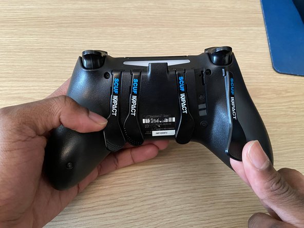

If the back button on your Scuf Impact Controller isn’t clicking properly or isn’t performing in the way it’s intended, use this guide to replace it. Before doing so, you must first inspect the back button of the controller to see if there are any pieces or solid objects preventing it from moving properly.
    1. Scuf Impact Controller Back Button Replacement, Back Button: crwdns2935265:01crwdnd2935265:01crwdnd2935265:01crwdne2935265:0
      • Place the controller so the back buttons are facing you.

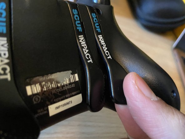

    2. Scuf Impact Controller Back Button Replacement: crwdns2935265:02crwdnd2935265:01crwdnd2935265:03crwdne2935265:0 Scuf Impact Controller Back Button Replacement: crwdns2935265:02crwdnd2935265:02crwdnd2935265:03crwdne2935265:0 Scuf Impact Controller Back Button Replacement: crwdns2935265:02crwdnd2935265:03crwdnd2935265:03crwdne2935265:0
      • Place an index finger behind the back button.
      • Place your thumb on the front of the back button.
    3. Scuf Impact Controller Back Button Replacement: crwdns2935265:03crwdnd2935265:01crwdnd2935265:02crwdne2935265:0 Scuf Impact Controller Back Button Replacement: crwdns2935265:03crwdnd2935265:02crwdnd2935265:02crwdne2935265:0
      • Slightly lift up your index finger and thumb at the same time.
    4. Scuf Impact Controller Back Button Replacement: crwdns2935265:04crwdnd2935265:01crwdnd2935265:02crwdne2935265:0 Scuf Impact Controller Back Button Replacement: crwdns2935265:04crwdnd2935265:02crwdnd2935265:02crwdne2935265:0
      • Push the back button upward until the top piece slides out.
    5. Scuf Impact Controller Back Button Replacement: crwdns2935265:05crwdnd2935265:01crwdnd2935265:03crwdne2935265:0 Scuf Impact Controller Back Button Replacement: crwdns2935265:05crwdnd2935265:02crwdnd2935265:03crwdne2935265:0 Scuf Impact Controller Back Button Replacement: crwdns2935265:05crwdnd2935265:03crwdnd2935265:03crwdne2935265:0
      • Turn the back button towards the closest controller handle and take it out.
    6. Scuf Impact Controller Back Button Replacement: crwdns2935265:06crwdnd2935265:01crwdnd2935265:01crwdne2935265:0
      • To remove the rest of the buttons, follow these steps again.
