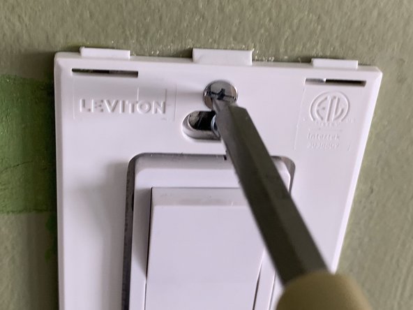

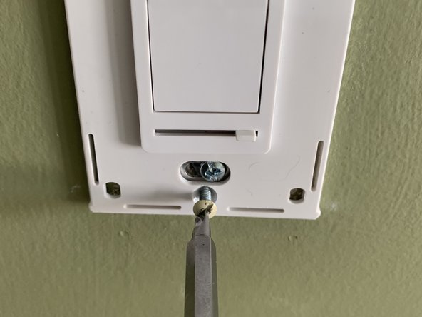

  4. Screwless Light Switch Wall Plate Replacement: crwdns2935265:04crwdnd2935265:01crwdnd2935265:02crwdne2935265:0 Screwless Light Switch Wall Plate Replacement: crwdns2935265:04crwdnd2935265:02crwdnd2935265:02crwdne2935265:0
    • Remove the inner part of the faceplate by unscrewing the two screws on the top and the bottom.
    • Different faceplates use different screws. Use the screwdriver that works with your screws.

  6. Screwless Light Switch Wall Plate Replacement: crwdns2935265:06crwdnd2935265:01crwdnd2935265:03crwdne2935265:0 Screwless Light Switch Wall Plate Replacement: crwdns2935265:06crwdnd2935265:02crwdnd2935265:03crwdne2935265:0 Screwless Light Switch Wall Plate Replacement: crwdns2935265:06crwdnd2935265:03crwdnd2935265:03crwdne2935265:0
    • Hold the inner layer of the faceplate against the wall.
    • Align the holes in the plate with the existing holes on the light switch or power outlet.
    • Tighten the two screws on the top and bottom.
