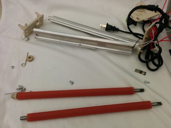

  1. Scotch TL901 Teardown, The Laminator: crwdns2935265:01crwdnd2935265:01crwdnd2935265:01crwdne2935265:0
    • The Scotch TL901 Laminator
  2. Scotch TL901 Teardown, Unscrewing the Case: crwdns2935265:02crwdnd2935265:01crwdnd2935265:01crwdne2935265:0
    • Using a small Phillips screwdriver, remove the screws from the bottom of the plastic case.
    • Rubber feet in the four corners must be removed first to gain access to the screws underneath. A sticker may also be covering the middle screw on the left.
  3. Scotch TL901 Teardown, The Opened Laminator: crwdns2935265:03crwdnd2935265:01crwdnd2935265:01crwdne2935265:0
    • Pull off the silver plastic cover and gain access to the internal components.
    • The rollers, motor, circuit board, and LEDs are all visible now.
  4. Scotch TL901 Teardown, The Circuit Board: crwdns2935265:04crwdnd2935265:01crwdnd2935265:01crwdne2935265:0
    • First unplug all three wire headers connected to the circuit board.
    • Unscrew the two screws holding down the circuit board by its corners and remove the board from the laminator.
  5. Scotch TL901 Teardown, The Spring: crwdns2935265:05crwdnd2935265:01crwdnd2935265:01crwdne2935265:0
    • Unhook the spring from the plastic surrounding the motor.
  6. Scotch TL901 Teardown, The Rollers: crwdns2935265:06crwdnd2935265:01crwdnd2935265:01crwdne2935265:0
    • Hold the roller enclosure from both sides, indicated by the markers, and pull upwards and slightly out.
    • Free access to the motor and rollers is now possible.
  7. Scotch TL901 Teardown, The Motor: crwdns2935265:07crwdnd2935265:01crwdnd2935265:01crwdne2935265:0
    • Remove the motor from the rollers by unscrewing the three screws holding them together.
  8. Scotch TL901 Teardown, The Sensor: crwdns2935265:08crwdnd2935265:01crwdnd2935265:01crwdne2935265:0
    • Remove the sensor from the roller enclosure by unscrewing the two spring-loaded screws.
  9. Scotch TL901 Teardown, The Other Side: crwdns2935265:09crwdnd2935265:01crwdnd2935265:01crwdne2935265:0
    • Unscrew the two screws and the bar on the other.
  10. Scotch TL901 Teardown, The Gears: crwdns2935265:010crwdnd2935265:01crwdnd2935265:01crwdne2935265:0
    • Pull the black washers sideways off the metal rod of the roller.
    • Pull the gears off.
  11. Scotch TL901 Teardown, The Disassembled Rollers: crwdns2935265:011crwdnd2935265:01crwdnd2935265:02crwdne2935265:0 Scotch TL901 Teardown, The Disassembled Rollers: crwdns2935265:011crwdnd2935265:02crwdnd2935265:02crwdne2935265:0
    • With the gears off, the plastic panel falls off and the rollers come out of the enclosure.
    • The laminator is now disassembled.

Why is the screw on the left side so hard to get out?
Teri L Geist - crwdns2934203:0crwdne2934203:0
Thank you..
Putting it back together is more of a challenge.
Frank - crwdns2934203:0crwdne2934203:0
You're right Frank. For me, getting it to stay together after the tear down and reassembly required superglue and two extra screws. ;) But at least it's working again. Thanks for the great instructions.
pjcall975 - crwdns2934203:0crwdne2934203:0
Thank you! Just needed to open and remove a jam. Followed your guide and all is well.
KQuinn
Kate Quinn - crwdns2934203:0crwdne2934203:0
Thank you for posting these instructions. I was able to remove a quarter that got trapped inside.
