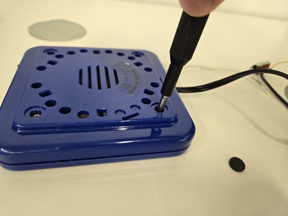

    • Flip over the cup warmer so that the underside is facing up.
    • Use your fingers or a spudger to lift and peel away the rubber pads.

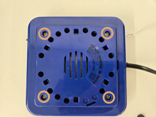

    • Remove the four 10 mm screws using a Phillips #2 screwdriver.
    • Flip over the cup warmer so that the top side is facing up, then lift away the front plate.

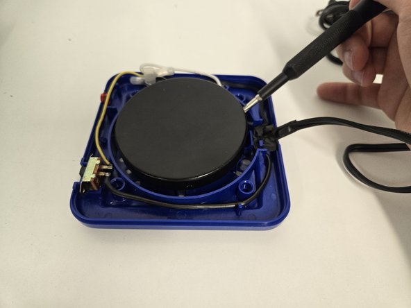

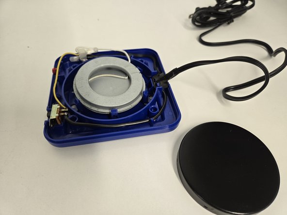

    • Insert a spudger under the cover of the heating assembly and pry it off.
    • Gently pull on the switch assembly and the LED to free it from the back plate.
    • Gently pull on the wire section connected directly to the power cord and the wire connected to the heating assembly to unclip them from the back plate.
    • You can now remove all the internal components from the back plate.
