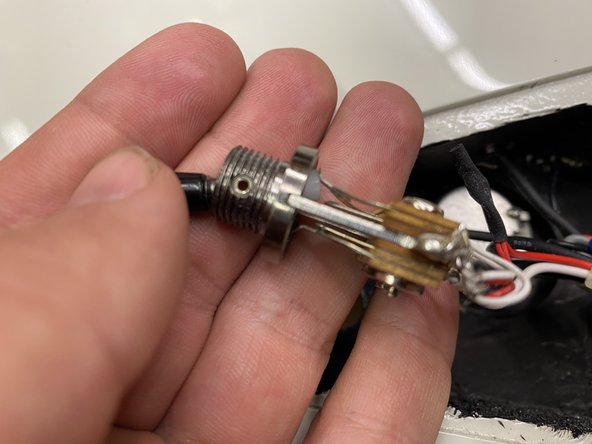

    • Note the position that the selector switch is in when the guitar has intermittent or no signal.
  2. Schecter Demon-7 Pickup Selector Switch Replacement: crwdns2935265:02crwdnd2935265:01crwdnd2935265:02crwdne2935265:0 Schecter Demon-7 Pickup Selector Switch Replacement: crwdns2935265:02crwdnd2935265:02crwdnd2935265:02crwdne2935265:0
    • Remove the retaining nut that holds the pickup selector switch to the guitar.
  3. Schecter Demon-7 Pickup Selector Switch Replacement: crwdns2935265:03crwdnd2935265:01crwdnd2935265:01crwdne2935265:0
    • Place the guitar face-down on a soft and clean surface.
  4. Schecter Demon-7 Pickup Selector Switch Replacement: crwdns2935265:04crwdnd2935265:01crwdnd2935265:02crwdne2935265:0 Schecter Demon-7 Pickup Selector Switch Replacement: crwdns2935265:04crwdnd2935265:02crwdnd2935265:02crwdne2935265:0
    • If the guitar has active pickups, open the battery tray and remove the 9-volt battery.
  5. Schecter Demon-7 Pickup Selector Switch Replacement: crwdns2935265:05crwdnd2935265:01crwdnd2935265:02crwdne2935265:0 Schecter Demon-7 Pickup Selector Switch Replacement: crwdns2935265:05crwdnd2935265:02crwdnd2935265:02crwdne2935265:0
    • Remove the large plastic backing plate.
  6. Schecter Demon-7 Pickup Selector Switch Replacement: crwdns2935265:06crwdnd2935265:01crwdnd2935265:02crwdne2935265:0 Schecter Demon-7 Pickup Selector Switch Replacement: crwdns2935265:06crwdnd2935265:02crwdnd2935265:02crwdne2935265:0
    • Carefully pull the pickup selector switch out of the body of the guitar.
  7. Schecter Demon-7 Pickup Selector Switch Replacement: crwdns2935265:07crwdnd2935265:01crwdnd2935265:01crwdne2935265:0
    • Switch the pickup selector switch to the side that does not work.
    • If neither side works, then repeat the next step on each side.
  8. Schecter Demon-7 Pickup Selector Switch Replacement: crwdns2935265:08crwdnd2935265:01crwdnd2935265:02crwdne2935265:0 Schecter Demon-7 Pickup Selector Switch Replacement: crwdns2935265:08crwdnd2935265:02crwdnd2935265:02crwdne2935265:0
    • Insert the sandpaper into the switch and proceed to scuff the contacts. Be sure to flip the sandpaper and scuff each side of the contact.
  9. Schecter Demon-7 Pickup Selector Switch Replacement: crwdns2935265:09crwdnd2935265:01crwdnd2935265:01crwdne2935265:0
    • Insert the switch back into the guitar, ensure that the switch is in the correct orientation.

Never thought of this method. Having the same problem with my son’s Demon 7 so the only solution I could think of was to buy a new switch but I can’t find the exact one. I’ll try this trick instead. Thanks!
Seth - crwdns2934203:0crwdne2934203:0
This worked great and exactly what I needed to fix my pickup selector switch on my Schector Omen 6. Though this should work for any pickup selector switch I'd think. I was getting intermittent issues and sometimes couldn't get the Bridge position to work at all. I was fearful I'd have to replace, so tried this first, and worked like a charm! Sounds perfect again, no new switch needed. Thank you.
Justin - crwdns2934203:0crwdne2934203:0
