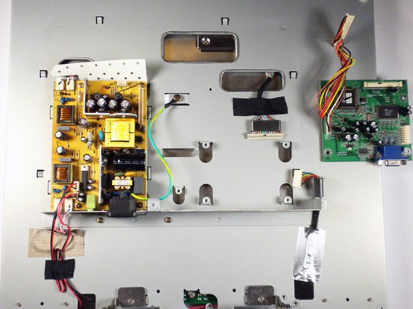

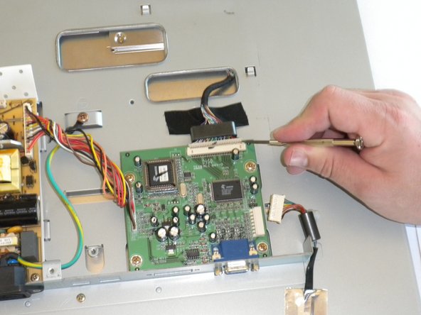

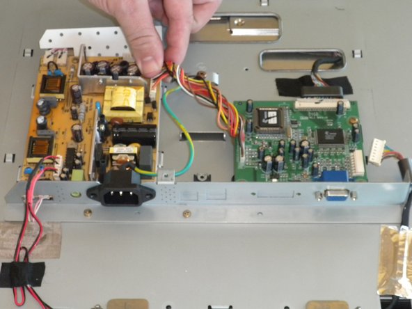

  6. Sceptre X9 Komodo VII Video Motherboard Replacement, Video Motherboard: crwdns2935265:07crwdnd2935265:01crwdnd2935265:03crwdne2935265:0 Sceptre X9 Komodo VII Video Motherboard Replacement, Video Motherboard: crwdns2935265:07crwdnd2935265:02crwdnd2935265:03crwdne2935265:0 Sceptre X9 Komodo VII Video Motherboard Replacement, Video Motherboard: crwdns2935265:07crwdnd2935265:03crwdnd2935265:03crwdne2935265:0
    • Use caution when removing the connectors as they can easily break when removing.
    • Disconnect the multi-pin connector at the top of the board by firmly grasping the connector and pulling to the side.
    • Disconnect the multi-pin connector that runs between the video motherboard and the power supply motherboard. Firmly grasp the connector and pull straight up.
    • A plastic opening tool can be used to assist in the removal of connectors.

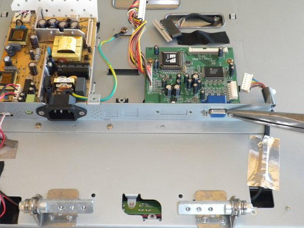

  7. Sceptre X9 Komodo VII Video Motherboard Replacement: crwdns2935265:08crwdnd2935265:01crwdnd2935265:02crwdne2935265:0 Sceptre X9 Komodo VII Video Motherboard Replacement: crwdns2935265:08crwdnd2935265:02crwdnd2935265:02crwdne2935265:0
    • Remove the two 3/16" hex head screws from the VGA connecter. Use a pair of needle nose pliers if a wrench is not available.
