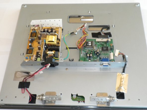

  6. Sceptre X9 Komodo VII Power Supply Unit Replacement, Power Supply Unit: crwdns2935265:07crwdnd2935265:01crwdnd2935265:01crwdne2935265:0
    • Using a #2 Phillips screwdriver, remove the two 4.72 mm Phillips screws that hold the power adapter in place.

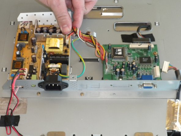

  7. Sceptre X9 Komodo VII Power Supply Unit Replacement: crwdns2935265:08crwdnd2935265:01crwdnd2935265:03crwdne2935265:0 Sceptre X9 Komodo VII Power Supply Unit Replacement: crwdns2935265:08crwdnd2935265:02crwdnd2935265:03crwdne2935265:0 Sceptre X9 Komodo VII Power Supply Unit Replacement: crwdns2935265:08crwdnd2935265:03crwdnd2935265:03crwdne2935265:0
    • Unplug the seven connections from the power supply unit by gently pulling on them.

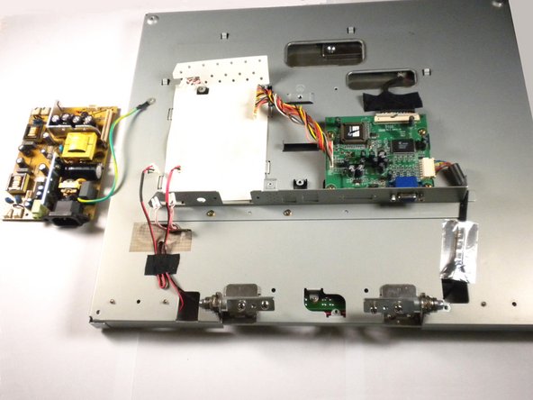

  8. Sceptre X9 Komodo VII Power Supply Unit Replacement: crwdns2935265:09crwdnd2935265:01crwdnd2935265:01crwdne2935265:0
    • Using a #2 Phillips screwdriver, remove the screws and the wire that is attached to the ground.
    • Four 6 mm Phillips screws
    • One 8 mm Phillips screw
  9. Sceptre X9 Komodo VII Power Supply Unit Replacement: crwdns2935265:010crwdnd2935265:01crwdnd2935265:02crwdne2935265:0 Sceptre X9 Komodo VII Power Supply Unit Replacement: crwdns2935265:010crwdnd2935265:02crwdnd2935265:02crwdne2935265:0
    • Lift the power supply unit straight up to remove it from the back panel.
