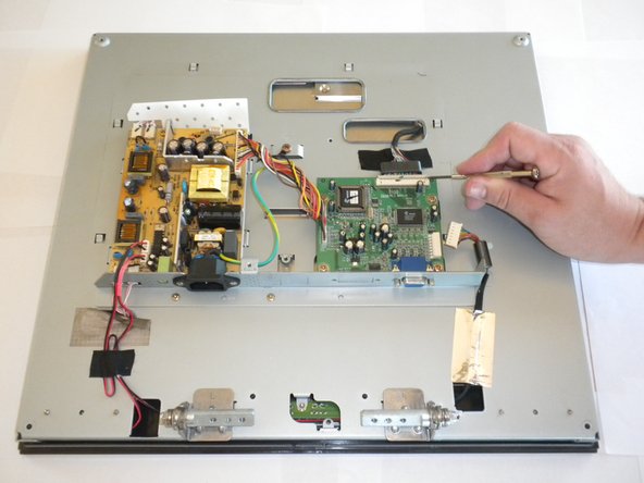

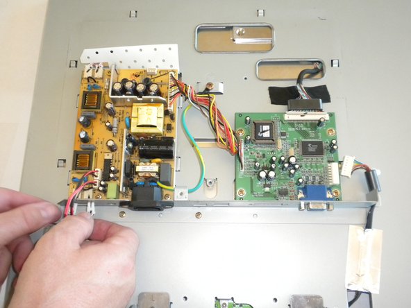

  6. Sceptre X9 Komodo VII Liquid Crystal Display Replacement, Liquid Crystal Display: crwdns2935265:07crwdnd2935265:01crwdnd2935265:03crwdne2935265:0 Sceptre X9 Komodo VII Liquid Crystal Display Replacement, Liquid Crystal Display: crwdns2935265:07crwdnd2935265:02crwdnd2935265:03crwdne2935265:0 Sceptre X9 Komodo VII Liquid Crystal Display Replacement, Liquid Crystal Display: crwdns2935265:07crwdnd2935265:03crwdnd2935265:03crwdne2935265:0
    • Use caution when removing the connectors as they can easily break when removing.
    • Disconnect the two connectors at the top-left of the power board.
    • Disconnect the two connectors at the very bottom of the power board (pink wire).
    • Disconnect the multi-pin connector at the top of the motherboard.
    • A small flat-blade screwdriver or tweezers can be used to assist in removal of connectors.

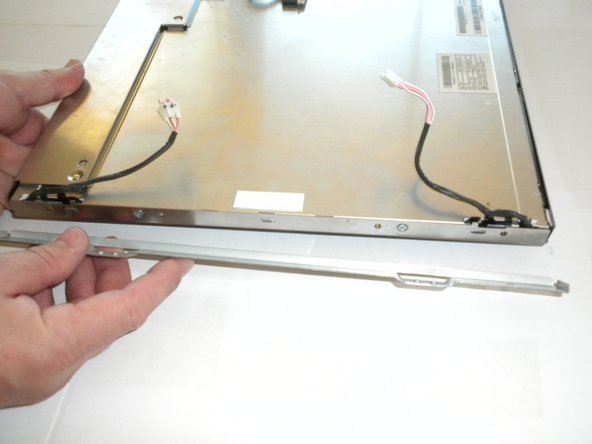

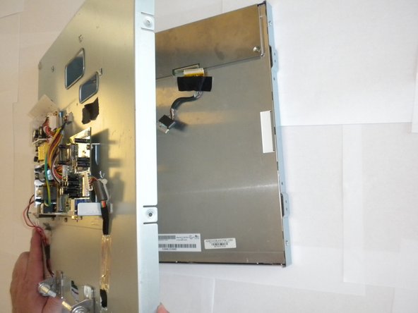

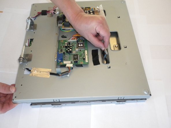

  7. Sceptre X9 Komodo VII Liquid Crystal Display Replacement: crwdns2935265:08crwdnd2935265:01crwdnd2935265:03crwdne2935265:0 Sceptre X9 Komodo VII Liquid Crystal Display Replacement: crwdns2935265:08crwdnd2935265:02crwdnd2935265:03crwdne2935265:0 Sceptre X9 Komodo VII Liquid Crystal Display Replacement: crwdns2935265:08crwdnd2935265:03crwdnd2935265:03crwdne2935265:0
    • Use a #2 Phillips to unscrew the two 4.5mm screws on each side of the back panel.
    • Carefully side the connectors through their respective openings.
    • Lif the back panel to reveal the LCD back cover.

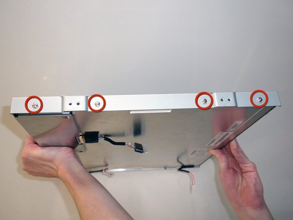

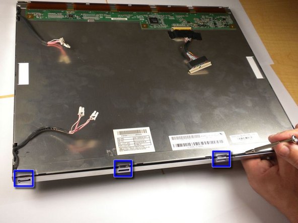

  8. Sceptre X9 Komodo VII Liquid Crystal Display Replacement, LCD Back Cover: crwdns2935265:09crwdnd2935265:01crwdnd2935265:03crwdne2935265:0 Sceptre X9 Komodo VII Liquid Crystal Display Replacement, LCD Back Cover: crwdns2935265:09crwdnd2935265:02crwdnd2935265:03crwdne2935265:0 Sceptre X9 Komodo VII Liquid Crystal Display Replacement, LCD Back Cover: crwdns2935265:09crwdnd2935265:03crwdnd2935265:03crwdne2935265:0
    • Use a #2 Phillips to remove the four 6mm screws on the bezel for each side of the back cover.
    • Remove the bezels from the LCD back cover (the bezels should simply fall off once the screws are removed).

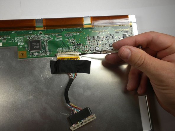

  9. Sceptre X9 Komodo VII Liquid Crystal Display Replacement: crwdns2935265:010crwdnd2935265:01crwdnd2935265:03crwdne2935265:0 Sceptre X9 Komodo VII Liquid Crystal Display Replacement: crwdns2935265:010crwdnd2935265:02crwdnd2935265:03crwdne2935265:0 Sceptre X9 Komodo VII Liquid Crystal Display Replacement: crwdns2935265:010crwdnd2935265:03crwdnd2935265:03crwdne2935265:0
    • Use a #0 Phillips to remove the three 4.5mm screws located on the LCD back cover.
    • Lift the inner panel to remove it.
    • Disconnect the muti-pin connector on the LCD back cover by firmly pulling down on it.

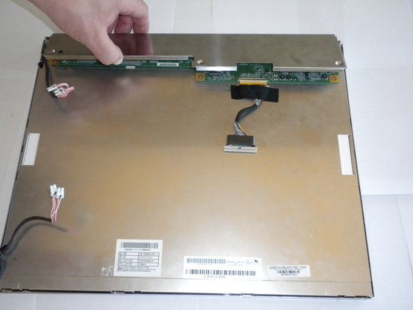

  10. Sceptre X9 Komodo VII Liquid Crystal Display Replacement: crwdns2935265:011crwdnd2935265:01crwdnd2935265:02crwdne2935265:0 Sceptre X9 Komodo VII Liquid Crystal Display Replacement: crwdns2935265:011crwdnd2935265:02crwdnd2935265:02crwdne2935265:0
    • Use a #0 Phillips to remove the two 6mm screws on each side of the LCD cover.
    • There are tabs holding down the cover. You may have to use a bit of force to pry them open.
    • A small flat-blade screwdriver can be used to pry off LCD cover.

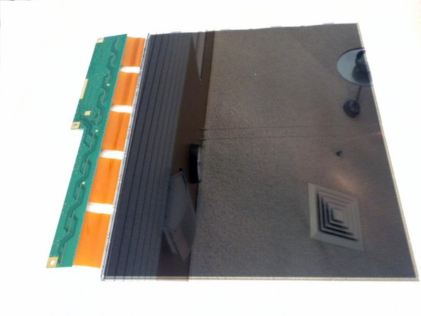

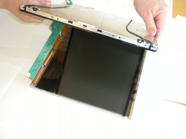

  11. Sceptre X9 Komodo VII Liquid Crystal Display Replacement: crwdns2935265:012crwdnd2935265:01crwdnd2935265:03crwdne2935265:0 Sceptre X9 Komodo VII Liquid Crystal Display Replacement: crwdns2935265:012crwdnd2935265:02crwdnd2935265:03crwdne2935265:0 Sceptre X9 Komodo VII Liquid Crystal Display Replacement: crwdns2935265:012crwdnd2935265:03crwdnd2935265:03crwdne2935265:0
    • Lift the LCD back cover to reveal the LCD screen below.
