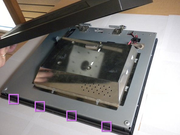

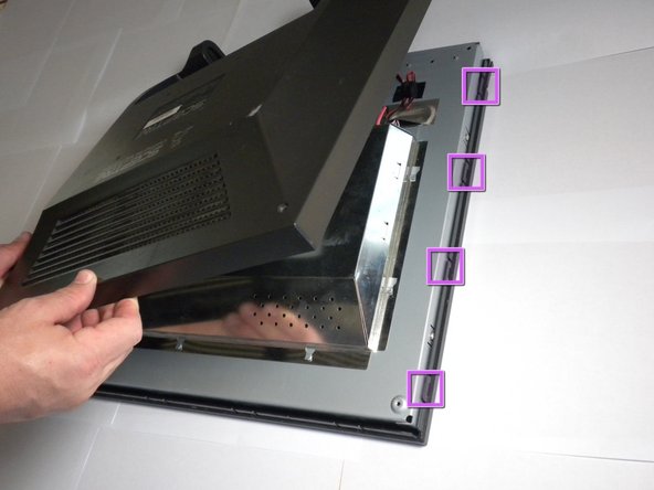

  4. Sceptre X9 Komodo VII Board Cover Replacement: crwdns2935265:05crwdnd2935265:01crwdnd2935265:03crwdne2935265:0 Sceptre X9 Komodo VII Board Cover Replacement: crwdns2935265:05crwdnd2935265:02crwdnd2935265:03crwdne2935265:0 Sceptre X9 Komodo VII Board Cover Replacement: crwdns2935265:05crwdnd2935265:03crwdnd2935265:03crwdne2935265:0
    • Pry the monitor using the plastic opening tool to release the clips holding the cover on.
    • There are four clips on each side, four on the top, and one on the bottom.
    • You may hear a loud snapping noise when releasing the clips. Do not be alarmed, it is natural.
    • Once all the clips have been released, remove the cover by pulling it up.

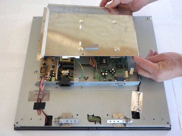

  5. Sceptre X9 Komodo VII Board Cover Replacement: crwdns2935265:06crwdnd2935265:01crwdnd2935265:02crwdne2935265:0 Sceptre X9 Komodo VII Board Cover Replacement: crwdns2935265:06crwdnd2935265:02crwdnd2935265:02crwdne2935265:0
    • Using the #2 Phillips screwdriver, remove the one 6mm screw.
    • Unplug the indicated cable by pulling on the base.
    • Slide the cover toward the top of the monitor.
    • Remove the cover.
