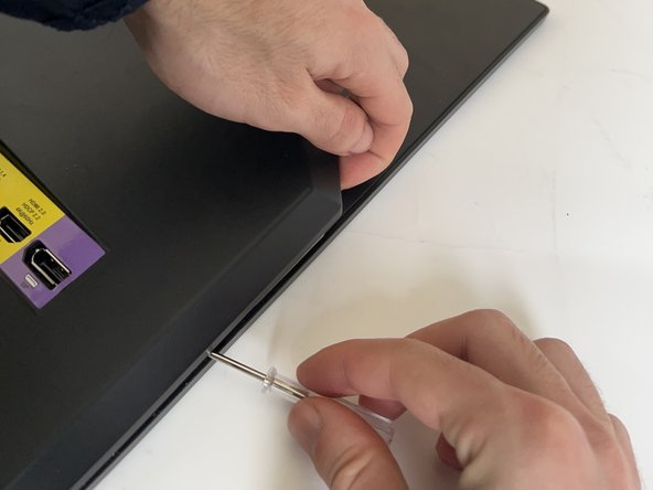

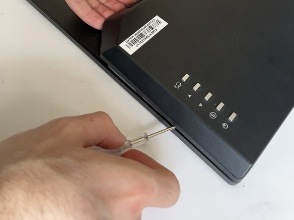

    • Hook the tip of the screwdriver in the right corner of the back case. Try to pull up the part by your hand while inserting the tip of the screwdriver.
    • Once the tip of the screwdriver is inside the corner, gently slide down the screwdriver to detach the right side of the back case from the screen.
  4. Sceptre 4K IPS 27" Monitor Button Board Replacement: crwdns2935265:04crwdnd2935265:01crwdnd2935265:03crwdne2935265:0 Sceptre 4K IPS 27" Monitor Button Board Replacement: crwdns2935265:04crwdnd2935265:02crwdnd2935265:03crwdne2935265:0 Sceptre 4K IPS 27" Monitor Button Board Replacement: crwdns2935265:04crwdnd2935265:03crwdnd2935265:03crwdne2935265:0

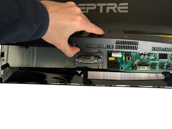

    • Do the same as the previous step with the left corner to detach the left part of the back case from the screen.
    • Open the back case of the screen.

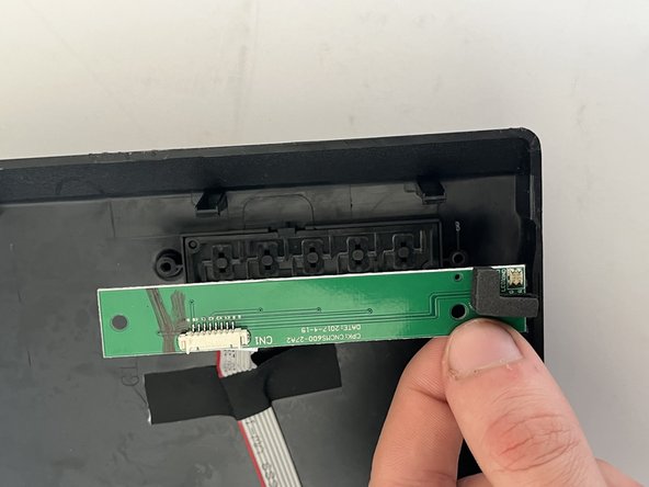

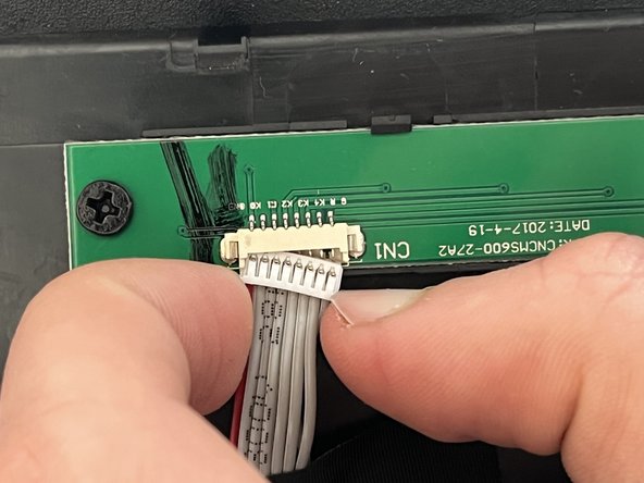

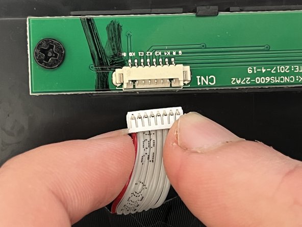

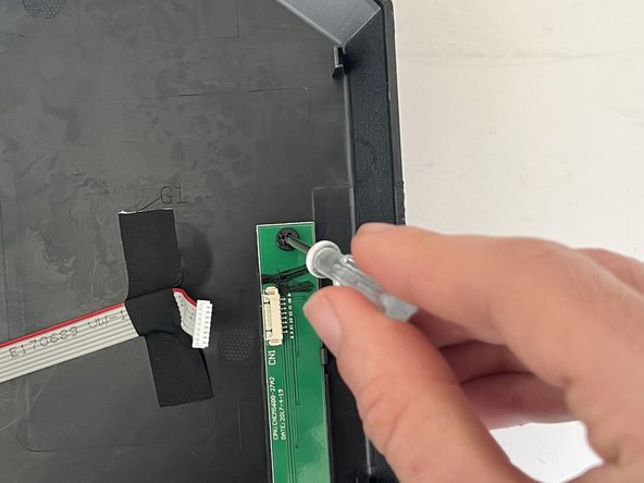

    • In the back of the case you will see the control buttons' board.
    • Disconnect the wire connection by pulling out the wire from the board.
  6. Sceptre 4K IPS 27" Monitor Button Board Replacement: crwdns2935265:06crwdnd2935265:01crwdnd2935265:03crwdne2935265:0 Sceptre 4K IPS 27" Monitor Button Board Replacement: crwdns2935265:06crwdnd2935265:02crwdnd2935265:03crwdne2935265:0 Sceptre 4K IPS 27" Monitor Button Board Replacement: crwdns2935265:06crwdnd2935265:03crwdnd2935265:03crwdne2935265:0
    • Remove the two screws from the board using a Phillips #00 screwdriver.
    • Remove the control button board from the device.
