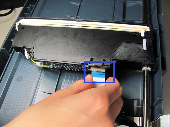

    1. Scanner Head Replacement, Detaching the Scanner Head: crwdns2935265:010crwdnd2935265:01crwdnd2935265:02crwdne2935265:0 Scanner Head Replacement, Detaching the Scanner Head: crwdns2935265:010crwdnd2935265:02crwdnd2935265:02crwdne2935265:0
      • Detach the white ribbon wire from the scanner head by pulling gently at the connection.

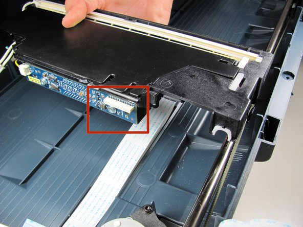

    2. Scanner Head Replacement, Removing the Scanner Head: crwdns2935265:011crwdnd2935265:01crwdnd2935265:02crwdne2935265:0 Scanner Head Replacement, Removing the Scanner Head: crwdns2935265:011crwdnd2935265:02crwdnd2935265:02crwdne2935265:0
      • Lift the gray drive belt from the black tab to disconnect the drive belt from the scanner head.
      • Remove the scanner head from the scanner by gently rotating and then lifting.
    3. Scanner Head Replacement, Adding New Scanner Head: crwdns2935265:012crwdnd2935265:01crwdnd2935265:02crwdne2935265:0 Scanner Head Replacement, Adding New Scanner Head: crwdns2935265:012crwdnd2935265:02crwdnd2935265:02crwdne2935265:0
      • Place the new scanner head in the scanner tray by fastening the drive belt into the black tab.
      • Make sure the tab on the outer portion of the gray drive belt is fastened.
      • Once the drive belt is secured, rotate the scanner head back into position.
      • Re-attach the white ribbon wire to the connection from Step 10.
