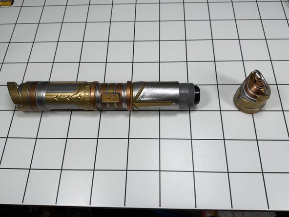

  1. Savi’s Workshop Hand built Lightsabers Batteries Replacement, Remove end cap: crwdns2935265:01crwdnd2935265:01crwdnd2935265:01crwdne2935265:0
    • Remove the bottom hilt end cap by twisting counter clockwise.

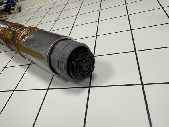

  2. Savi’s Workshop Hand built Lightsabers Batteries Replacement, Remove Battery Box: crwdns2935265:02crwdnd2935265:01crwdnd2935265:03crwdne2935265:0 Savi’s Workshop Hand built Lightsabers Batteries Replacement, Remove Battery Box: crwdns2935265:02crwdnd2935265:02crwdnd2935265:03crwdne2935265:0 Savi’s Workshop Hand built Lightsabers Batteries Replacement, Remove Battery Box: crwdns2935265:02crwdnd2935265:03crwdnd2935265:03crwdne2935265:0
    • Remove the battery pack.
    • Hold the saber body in one hand and with the other twist the black battery box(also has speaker in it) about 1/4 turn clockwise.
    • Pull battery box from the hilt handle.
