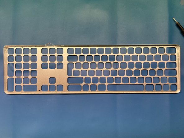

  1. Satechi Aluminum Keyboard Disassembly, Removing the bottom plate: crwdns2935265:02crwdnd2935265:01crwdnd2935265:03crwdne2935265:0 Satechi Aluminum Keyboard Disassembly, Removing the bottom plate: crwdns2935265:02crwdnd2935265:02crwdnd2935265:03crwdne2935265:0 Satechi Aluminum Keyboard Disassembly, Removing the bottom plate: crwdns2935265:02crwdnd2935265:03crwdnd2935265:03crwdne2935265:0
    • Remove the rubber feet (they are simply glued in place)
    • Use a heat source to soften the adhesive that holds down the bottom plate
    • Check the pictures to see where the adhesive is applied inside the device
    • Use a plastic pick or some other tool to cut through the adhesive
    • Remove the bottom plate

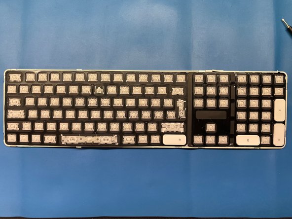

  2. Satechi Aluminum Keyboard Disassembly, Removing the top cover: crwdns2935265:03crwdnd2935265:01crwdnd2935265:03crwdne2935265:0 Satechi Aluminum Keyboard Disassembly, Removing the top cover: crwdns2935265:03crwdnd2935265:02crwdnd2935265:03crwdne2935265:0 Satechi Aluminum Keyboard Disassembly, Removing the top cover: crwdns2935265:03crwdnd2935265:03crwdnd2935265:03crwdne2935265:0
    • In order to get to the electronics inside we have to first remove the aluminium top cover
    • This is necessary because the plastic with the electronics underneath is clued to the top cover and is not removable without removing the clue
    • To remove the top cover first check out the images to see where to adhesive is applied on the cover
    • Use some heat source to soften the adhesive
    • Use a plastic pick or some other tool to cut through the adhesive (if the adhesive is really soft then simply applying pressure to the keycaps can help remove the cover)
    • Remove the cover

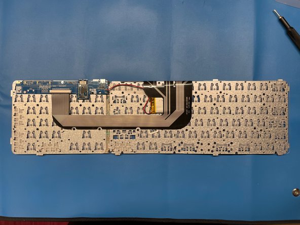

  3. Satechi Aluminum Keyboard Disassembly, Remove plastic cover: crwdns2935265:04crwdnd2935265:01crwdnd2935265:03crwdne2935265:0 Satechi Aluminum Keyboard Disassembly, Remove plastic cover: crwdns2935265:04crwdnd2935265:02crwdnd2935265:03crwdne2935265:0 Satechi Aluminum Keyboard Disassembly, Remove plastic cover: crwdns2935265:04crwdnd2935265:03crwdnd2935265:03crwdne2935265:0
    • Start by removing the twelve Phillips #00 screws marked in the picture
    • Now you should be able to lift the plastic cover
