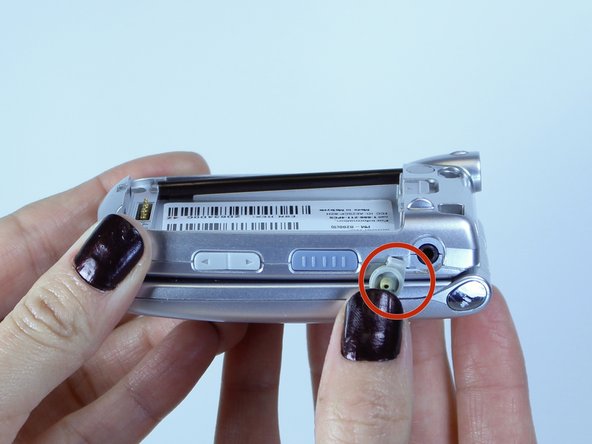

  5. Sanyo-PM 8200 Keypad Replacement: crwdns2935265:05crwdnd2935265:01crwdnd2935265:02crwdne2935265:0 Sanyo-PM 8200 Keypad Replacement: crwdns2935265:05crwdnd2935265:02crwdnd2935265:02crwdne2935265:0
    • Pry the back casing off the device using a spudger. Work your way along the edges to completely separate the back casing from the device.
    • This step may require extra force. But too much force could break the back casing.
    • Remove the headphone jack cover when separating the back casing. The headphone jack is located on the opposite side of the antenna.

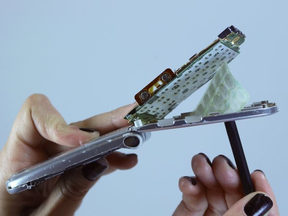

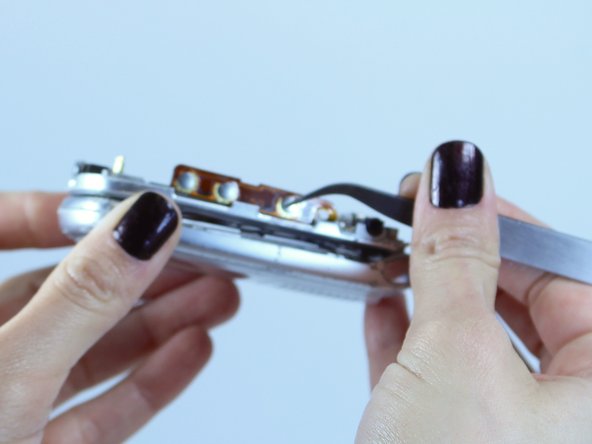

  7. Sanyo-PM 8200 Keypad Replacement: crwdns2935265:07crwdnd2935265:01crwdnd2935265:01crwdne2935265:0
    • Place the plastic opening tool underneath the motherboard and gently lift up.
    • Be careful not to damage the flex cable ribbon connecting the motherboard to the device.

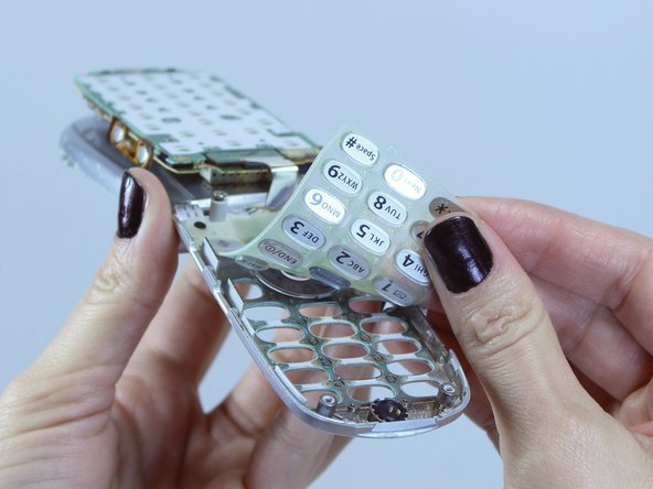

  8. Sanyo-PM 8200 Keypad Replacement: crwdns2935265:08crwdnd2935265:01crwdnd2935265:03crwdne2935265:0 Sanyo-PM 8200 Keypad Replacement: crwdns2935265:08crwdnd2935265:02crwdnd2935265:03crwdne2935265:0 Sanyo-PM 8200 Keypad Replacement: crwdns2935265:08crwdnd2935265:03crwdnd2935265:03crwdne2935265:0
    • Flip open the phone to reveal the keypad.
    • Place the plastic opening tool underneath the keypad and gently push the keypad towards the motherboard.
    • Remove the keypad.

In almost all flip phones, there’s a flex cable ribbon that connects the motherboard to the display side of the phone. It is permanently attached to the display side and plugs into the motherboard. As there are anywhere from 16 to 50 connections in the cable, I recommend being careful NOT to unplug it…aligning it for plugging it back in properly can be tricky!
