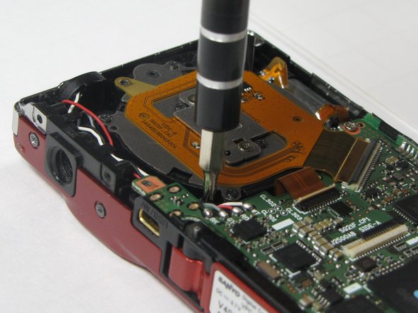

  7. Sanyo VPC-X1200 Main Board Replacement, Lens Unit: crwdns2935265:07crwdnd2935265:01crwdnd2935265:01crwdne2935265:0
    • Disconnect the two ribbon cables from the lens unit by using the spudger to lift the ribbon gates.
    • One gate is black and another is white.
  8. Sanyo VPC-X1200 Main Board Replacement: crwdns2935265:08crwdnd2935265:01crwdnd2935265:02crwdne2935265:0 Sanyo VPC-X1200 Main Board Replacement: crwdns2935265:08crwdnd2935265:02crwdnd2935265:02crwdne2935265:0
    • Remove the three silver screws.
    • Three 5.5mm screws

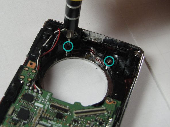

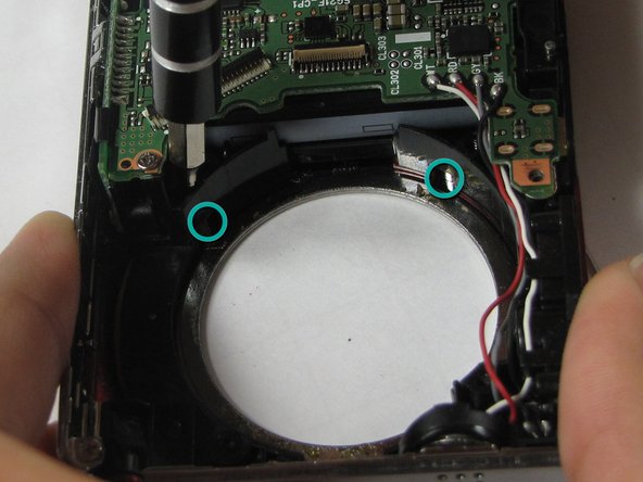

  10. Sanyo VPC-X1200 Main Board Replacement, Flash Lens: crwdns2935265:010crwdnd2935265:01crwdnd2935265:03crwdne2935265:0 Sanyo VPC-X1200 Main Board Replacement, Flash Lens: crwdns2935265:010crwdnd2935265:02crwdnd2935265:03crwdne2935265:0 Sanyo VPC-X1200 Main Board Replacement, Flash Lens: crwdns2935265:010crwdnd2935265:03crwdnd2935265:03crwdne2935265:0
    • Remove 4 screws attached to the exterior silver bezel.
    • Four 3.5mm screws
  11. Sanyo VPC-X1200 Main Board Replacement: crwdns2935265:011crwdnd2935265:01crwdnd2935265:01crwdne2935265:0
    • Remove round silver bezel from the front of the camera.

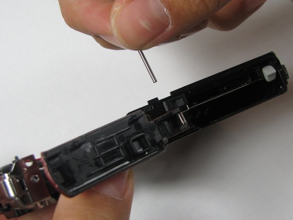

  16. Sanyo VPC-X1200 Main Board Replacement, Main Board: crwdns2935265:016crwdnd2935265:01crwdnd2935265:03crwdne2935265:0 Sanyo VPC-X1200 Main Board Replacement, Main Board: crwdns2935265:016crwdnd2935265:02crwdnd2935265:03crwdne2935265:0 Sanyo VPC-X1200 Main Board Replacement, Main Board: crwdns2935265:016crwdnd2935265:03crwdnd2935265:03crwdne2935265:0
    • Push out pin that holds the door hinge together
    • Pull out the pin. Be careful to keep track of the spring and black spacer.
    • Set the battery door aside
