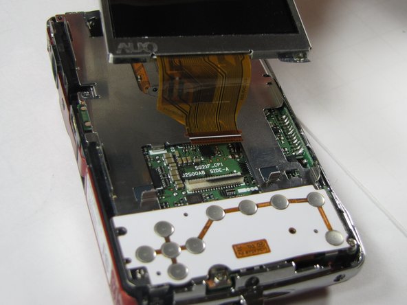

  3. Sanyo VPC-X1200 Button Plate Replacement, LCD Screen: crwdns2935265:03crwdnd2935265:01crwdnd2935265:02crwdne2935265:0 Sanyo VPC-X1200 Button Plate Replacement, LCD Screen: crwdns2935265:03crwdnd2935265:02crwdnd2935265:02crwdne2935265:0
    • Gently lift up on the left side of the LCD and slowly pull it to the left side of the camera but do not remove entirely, there is a ribbon connector.
    • Be careful not to rip out the ribbon connector.

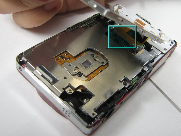

  4. Sanyo VPC-X1200 Button Plate Replacement: crwdns2935265:04crwdnd2935265:01crwdnd2935265:02crwdne2935265:0 Sanyo VPC-X1200 Button Plate Replacement: crwdns2935265:04crwdnd2935265:02crwdnd2935265:02crwdne2935265:0
    • To clear the ribbon connection underneath the screen, lift up the black ribbon gate with the spudger.
    • Gently lift ribbon out of the gate and set screen aside.

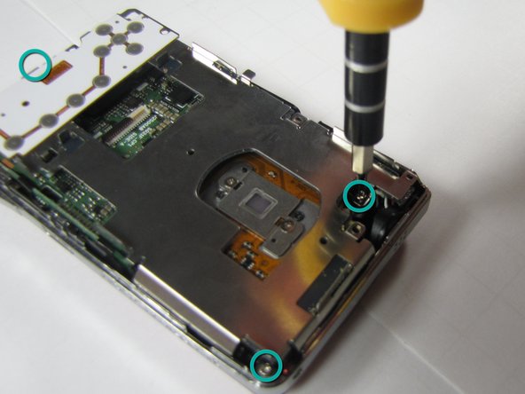

  5. Sanyo VPC-X1200 Button Plate Replacement, Button Plate: crwdns2935265:05crwdnd2935265:01crwdnd2935265:02crwdne2935265:0 Sanyo VPC-X1200 Button Plate Replacement, Button Plate: crwdns2935265:05crwdnd2935265:02crwdnd2935265:02crwdne2935265:0
    • There are five screws of three different sizes which need removal.
    • One 4.5mm screw
    • Four 3.5mm screws, one on the button side
    • One 5.5mm screws

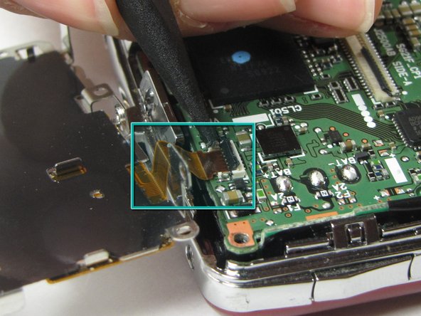

    • Slowly lift metal tray to the right.
    • Be careful not to bend the screw tabs or rip out the ribbon cable.
    • Remove ribbon cable by using the spudger to lift up the black ribbon gate to release the ribbon
