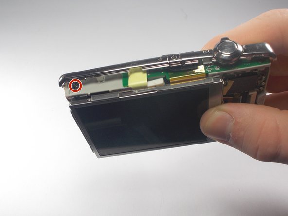

    1. Sanyo VPC-T850 Shutter Button Replacement, Shutter Button: crwdns2935265:010crwdnd2935265:01crwdnd2935265:01crwdne2935265:0
      • Find the chrome framing located on the top of the camera.
      • The physical shutter button apparatus is directly attached to this frame.
    2. Sanyo VPC-T850 Shutter Button Replacement: crwdns2935265:011crwdnd2935265:01crwdnd2935265:02crwdne2935265:0 Sanyo VPC-T850 Shutter Button Replacement: crwdns2935265:011crwdnd2935265:02crwdnd2935265:02crwdne2935265:0
      • Remove the three black screws connecting the chrome frame to the camera.
      • Three screws are located toward the front, with the remaining one above the display.
    3. Sanyo VPC-T850 Shutter Button Replacement: crwdns2935265:012crwdnd2935265:01crwdnd2935265:01crwdne2935265:0
      • Gently remove the loosened chrome frame and connected shutter button from the camera.
James Robinson
