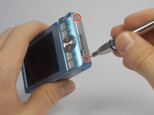

      • Using your Phillips #000 Screwdriver, remove the eight screws located around the sides and bottom of the camera.
      • Be sure to keep track of the side each screw comes from, as they come in different lengths.

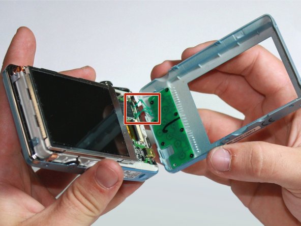

      • Orient the camera so the display is facing up.
      • Gently pull off the rear panel surrounding the display.
      • There are still three green wires connecting the panel to the rest of the camera.
      • Use your prying tool if you have difficulties removing the panel by hand.
    3. Sanyo VPC-T850 Lens Replacement: crwdns2935265:07crwdnd2935265:01crwdnd2935265:01crwdne2935265:0
      • Remove the eight black screws connecting the keypad circuit board to the rear panel.
    4. Sanyo VPC-T850 Lens Replacement: crwdns2935265:08crwdnd2935265:01crwdnd2935265:02crwdne2935265:0 Sanyo VPC-T850 Lens Replacement: crwdns2935265:08crwdnd2935265:02crwdnd2935265:02crwdne2935265:0

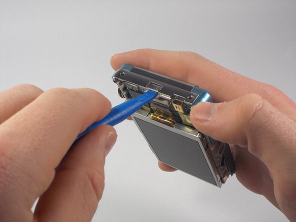

      • With a plastic opening tool, gently remove the chrome framing on the left and right sides of the camera.

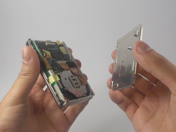

    2. Sanyo VPC-T850 Lens Replacement: crwdns2935265:014crwdnd2935265:01crwdnd2935265:02crwdne2935265:0 Sanyo VPC-T850 Lens Replacement: crwdns2935265:014crwdnd2935265:02crwdnd2935265:02crwdne2935265:0
      • Flip the camera back around to the other side.
      • Remove the four black screws connecting the metal display holder to the camera.
      • You do not have to remove the three screws located near the center.
      • Gently lift the display holder to reveal the underside of the lens.

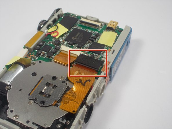

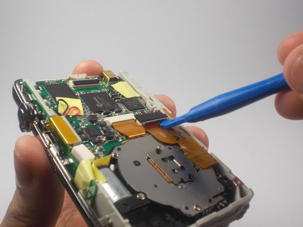

      • Locate where the larger orange ribbon is plugged into the motherboard.
      • There should be a rectangular foam piece covering the part it is plugged into.
      • Using your plastic opening tool, gently lift the edge of the rectangle where the orange ribbon is connected.
